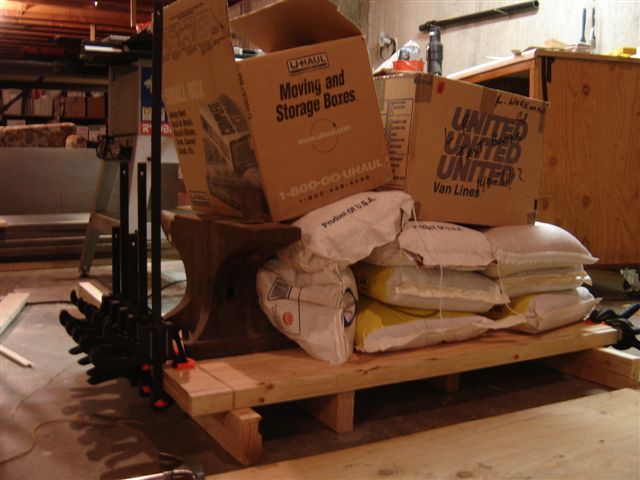

    My current "project" is to build myself a router table top. "Why not buy one," you say? But, what would I learn from that?
    So tonight, with my two pieces of 3/4" ply, set out to marry these two independant portions of lumber. "This is wonderful," I think to myself... "I am building!" "Using God's creations to ceate something useful and beautiful."
    Soon enough, however, doubt krept in... "Do I have enough clamps?" "Of course you do! You have a master's degree in ELECTRICAL Engineering, that's basically the same as wood anyway."
    So off I go, glue, glue, glue... clamp, clamp, clamp... Hmmmm, those edges aren't exactly touching... "More clamps!" I shout to the attending nurse. My mind responds with a weak, "There are no more clamps..."
    Well, but I'm an engineer... I can make due. If there are no clamps, we'll use weight! Gravity will be our clamp!
    What is heavy? Hmmm (by this time my education is kicking in)... Iron is heavy! Yes, yes, I have some iron, what else? Food is heavy! And books, books are heavy! So I gather my resources...
    My last house was way out in the country with some outbuildings. While rummaging around out there one day I came across an old anvil nailed to a stump. I couldn't just leave it there could I? Add to my list 1 anvil (140lbs)
    I'm mormon. That means I believe in being prepared in the case of emergency or hardship, which in turn means I believe in having a solid supply of food on hand. Add to my list 200lbs wheat, 25lbs rice, 25lbs pintos, 25 lbs sugar, 25lbs rolled oats, 20lbs random legumes.
    I mentioned I have a masters in engineering. Add to my list 100lbs useless text books.
    So, you pile this all on your router tabletop-in-the-making and what do you get?
Name:	Feb 2006 002.jpg
    It looks like it might actually work... I'll see how it looks after it dries and I trim it up a bit. Luckily I didn't spend a fortune on the plywood.
    So...here's to education, food, and wood!

    What??? You didn't park your car on it???

              I like the car idea, embarassed I haven't thought of that. Hmmmm need a true flat section of floor, the Jeep has the widest tires .........

                            Must be nice to be an EE with a Master's degree at the age of 13 (Honestly, that's what your profile says). Took me until I was 23 to get my Master's in EE.
                            Anyway, here's something to learn for today: MDF is much better for this kind of thing - lays perfectly flat sheet after sheet...
                            Something else to learn: Maybe some well placed screws from the bottom sheet to the top sheet would work just as well as clamps or weight...
                            Just make sure that the threads are not in the bottom sheet by using a larger clearance hole in the bottom sheet, that will allow pulling the sheets together.

                              i wish i'da taken pics of my "ultimate tool station' when making the torsion box on the bottom.
                              i had a wall of cinderblocks that came outta my garden (they formed raised beds) and stacked em all on the mdf for my big glue up, had ever single clamp on there too, its when i realized 187 clamps isnt gonna cover every situation
                              :P
                              nice job, i wish i thought of the car idea too! 1 wheel on there would been perfect!,
