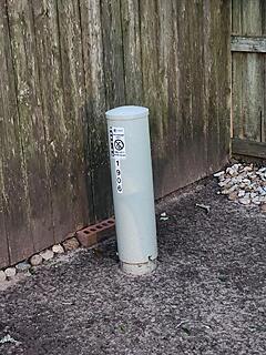

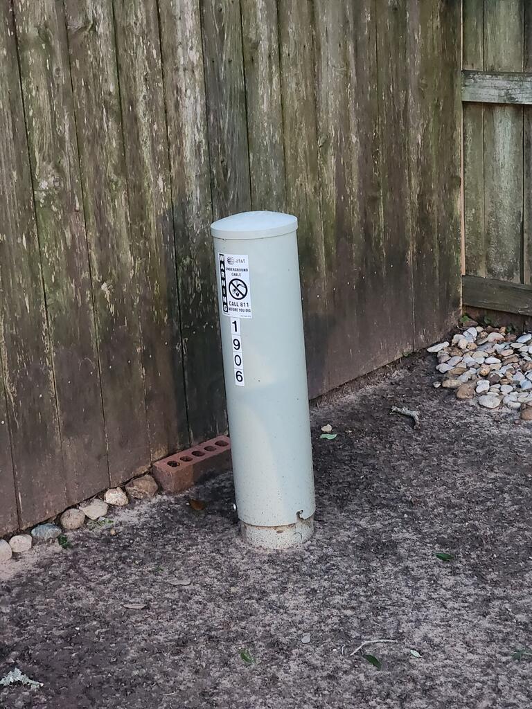

    THere's this thing from the phone company in the backyard. Good looking, no?
    Click image for larger version  Name:	20240519_201402.jpg Views:	0 Size:	175.2 KB ID:	858933

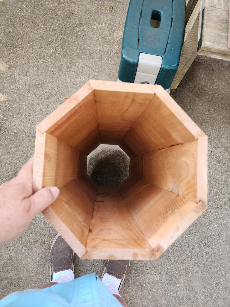

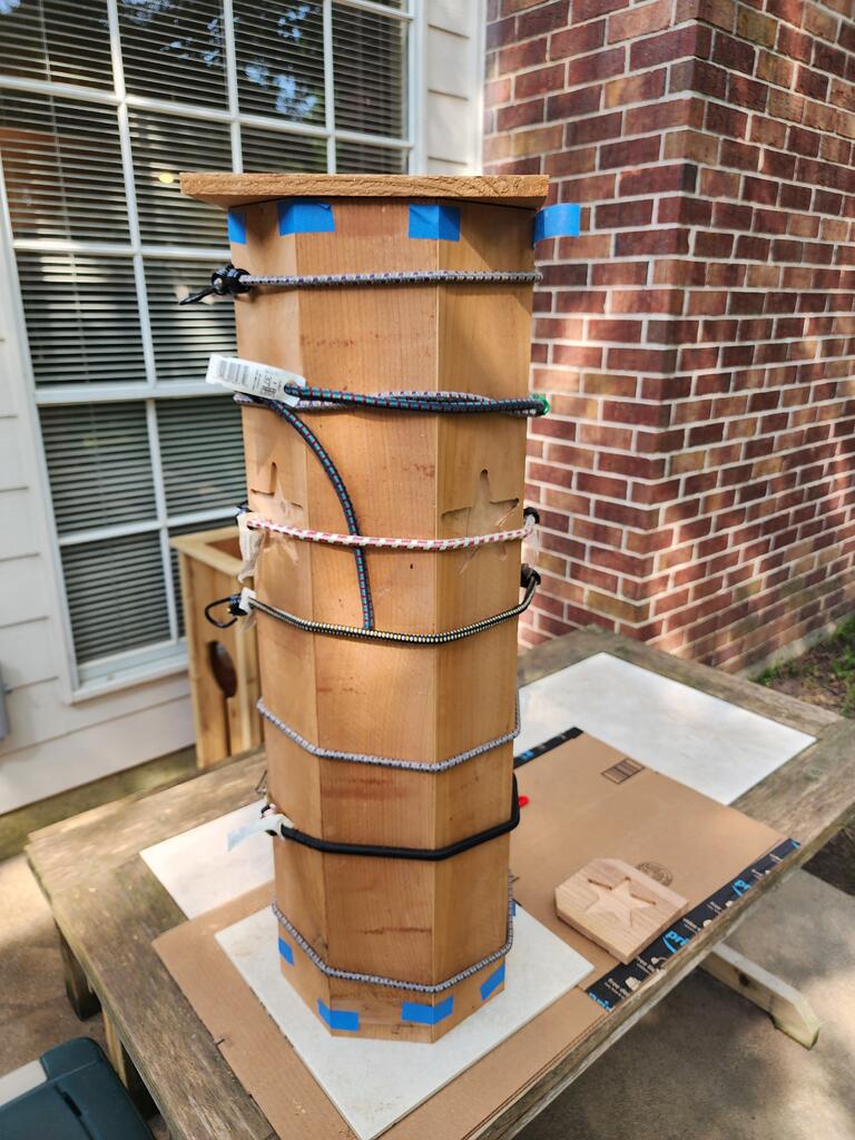

    Built an octagonal column plant stand that fits over it and holds a potted plant.

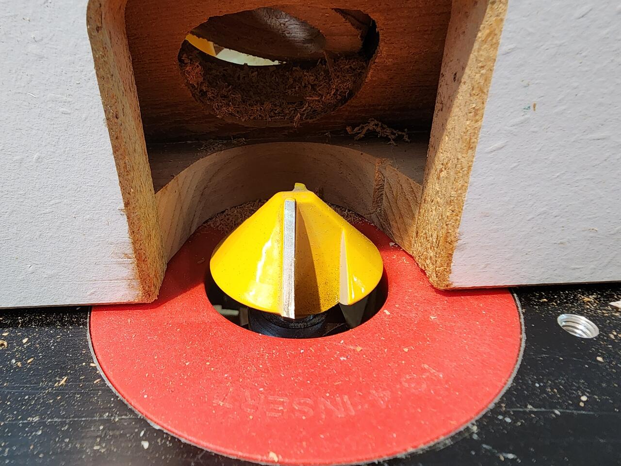

    Used the Birdsmouth router bit.
    Click image for larger version  Name:	20240519_173452.jpg Views:	0 Size:	201.9 KB ID:	858932

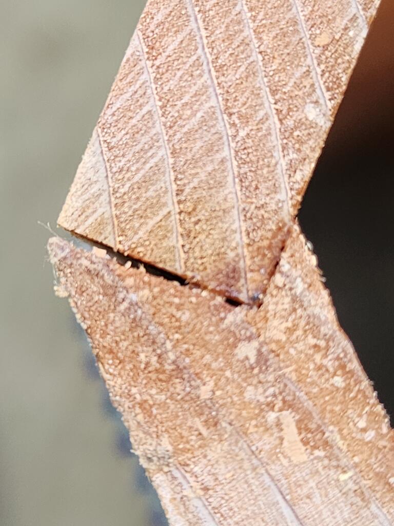

    The joint - the gap looks bad, but that's not bad because these were 33" long glue-ups..
    Click image for larger version  Name:	20240519_173818.jpg Views:	0 Size:	103.8 KB ID:	858936

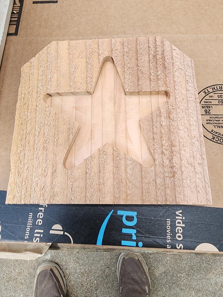

    Decided it needed something of interest on the side, had a small star I made and used it as a router template - this is the test cut:
    Click image for larger version  Name:	20240519_162829.jpg Views:	0 Size:	165.7 KB ID:	858941
    Holding 8 long pieces glue up was a bear... one doing it fast enough before it set and getting them all aligned. Even with two other sets of hands it was a losing battle like corralling monkeys until I recalled how I did it the time before... using masking tape to just align the corners. Then I threw some bungee cords around it to provide some clamping pressure while it set up.

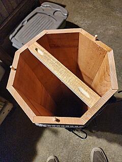

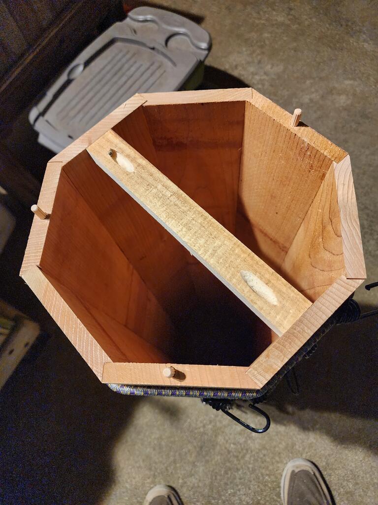

    Put a brace across the top with pocket hole jig, added some dowels to seat the top.
    Click image for larger version  Name:	20240519_173741.jpg Views:	0 Size:	133.8 KB ID:	858937 Click image for larger version  Name:	20240519_212410.jpg Views:	0 Size:	109.1 KB ID:	858938

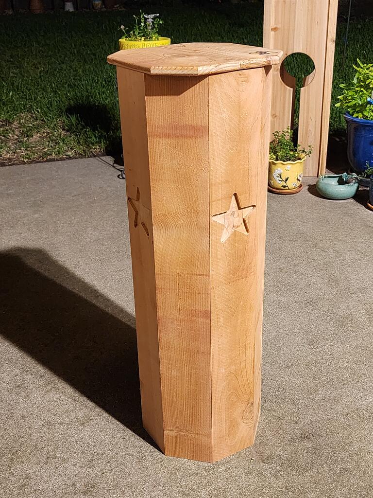

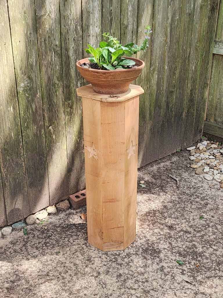

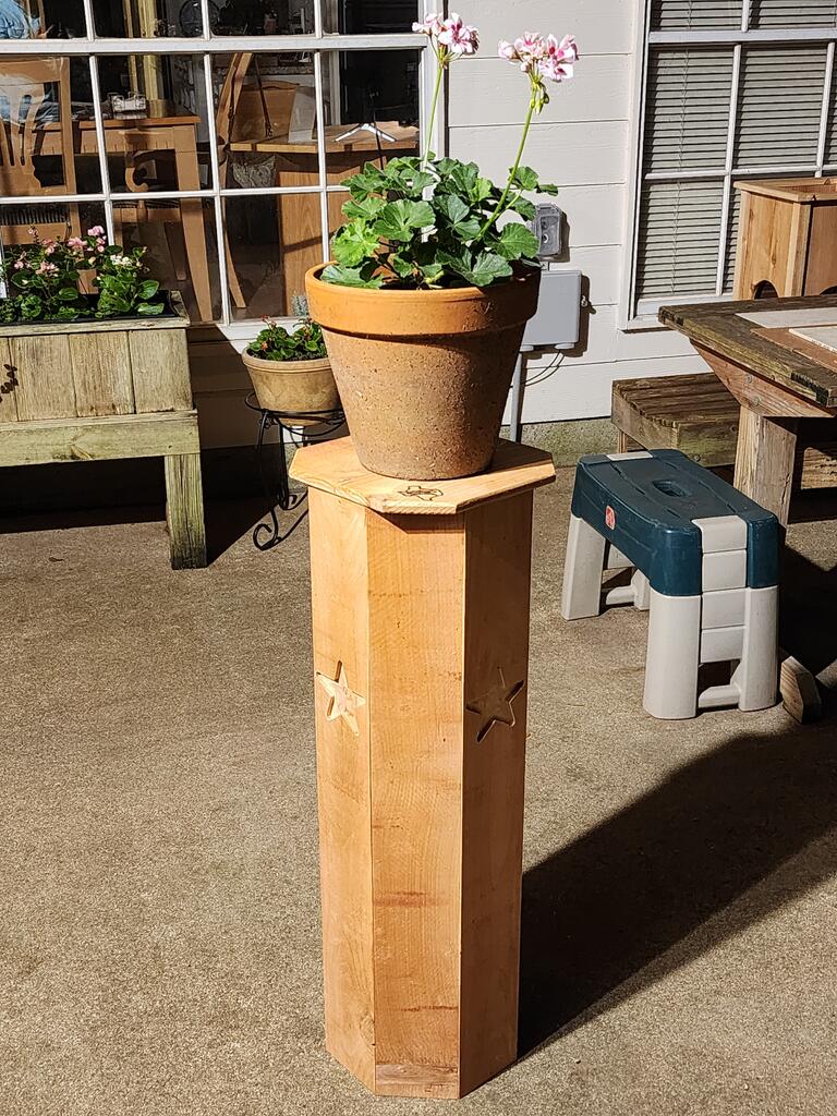

    Here's how it turned out... going to put it over the junction box tomorrow when its light out.
    Click image for larger version  Name:	20240519_233712.jpg Views:	0 Size:	178.9 KB ID:	858942 Click image for larger version  Name:	20240519_233618.jpg Views:	0 Size:	193.3 KB ID:	858934

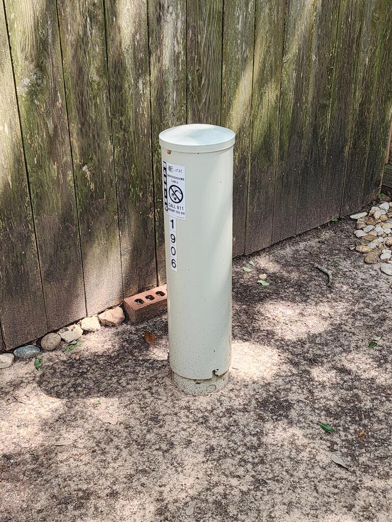

    I wonder if the service man will be able to find his junction box? Doesn't bother me, I cut the cord a few months ago.

      capncarl commented
      If you have telephone trouble you are out of luck…. They will never find the connection box.
      LCHIEN commented
      Capncarl, I am not worried. I disconnected the services that came though this box six months ago. If the service guy can't figure it out, I'll tell him. He has maps and knows its here somewhere.
      And hey, even though I cut the cord 6 months ago they had the gall to send me a letter and say they lost my credentials in a data breach last week. Sheesh.
    • 22106
    AFAIK, the phone company has not lifted by stand in search of the box in the last year and a half. The box contains access to the old POTS and ADSL wired telephone lines. Most of my neighbors have switched to fiber, cable or gone cellular in their telecom needs.
