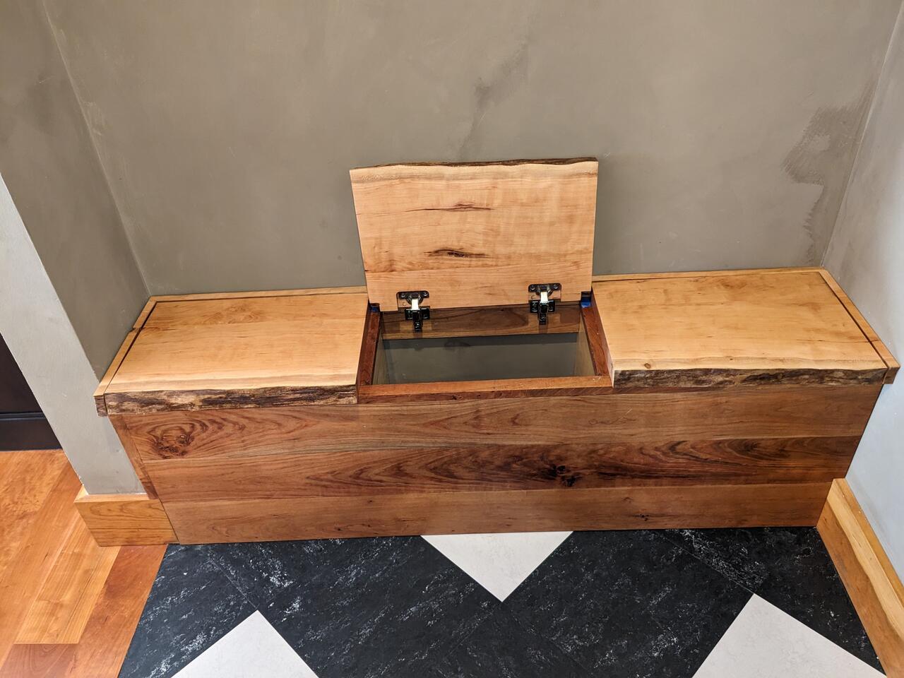

    I made this bench as a built-in in an alcove in the mudroom in the back of our house. It's a place to sit and put your boots on:
    It has three compartments -- hats, gloves and scarves.

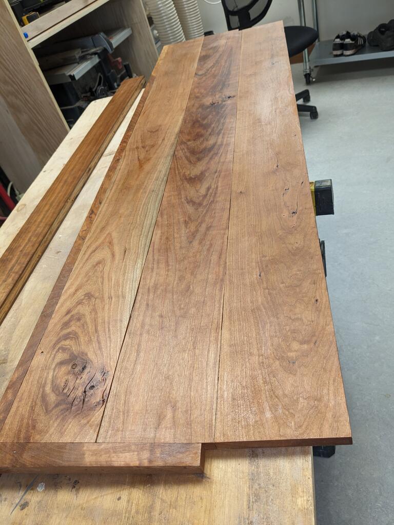

      For the front, I had one piece of the same 1x6 trim that the baseboard is made from. I also had a piece of stair nosing that we had bought but never used on the stairs, it was 10' long and about 6" wide, with a lip on the front of about 1-1/2". I ran it through the planer to take the lip off and ended up with a piece about 5/8" thick, after taking the roundover off the front it was about 5" wide. I cut it in half, planed the 1x6 to the same thickness, and glued all three together with biscuits to make a piece about 15" wide and 60" long:
      Click image for larger version  Name:	PXL_20231125_195642764.jpg Views:	0 Size:	117.8 KB ID:	857198
      The right side goes into the wall so I just notched it to fit over the baseboard and scribed it to the wall. The left side protrudes from the wall the thickness of the baseboard, so I attached a piece of leftover 1x2 trim to conceal that edge. I also ran a piece of 1x2 across the top to give a bit of a lip. Those pieces were just attached with glue and a finish nailer.

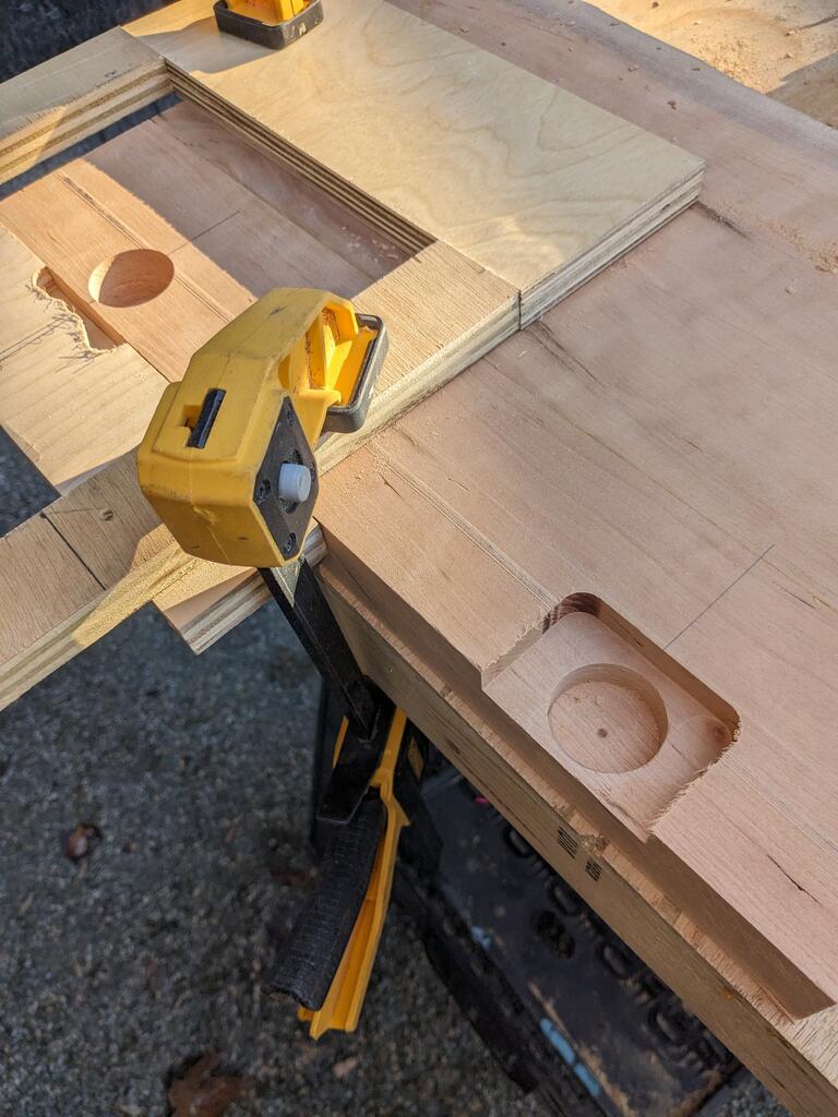

        For the hinges I used inset cabinet hinges. This was tricky because they expect the doors to be no more than 3/4" thick, and the doors were 1-1/2" thick. So I had to route out where the hinges attach to get the hinge within 3/4" of the surface:
        I just made a simple guide out of few pieces of scrap plywood. After some thought I drilled the cup holes before routing, because I wouldn't have been able to attach the jig after routing. Surprisingly I was able to set the depth deep enough, about 1-1/4".

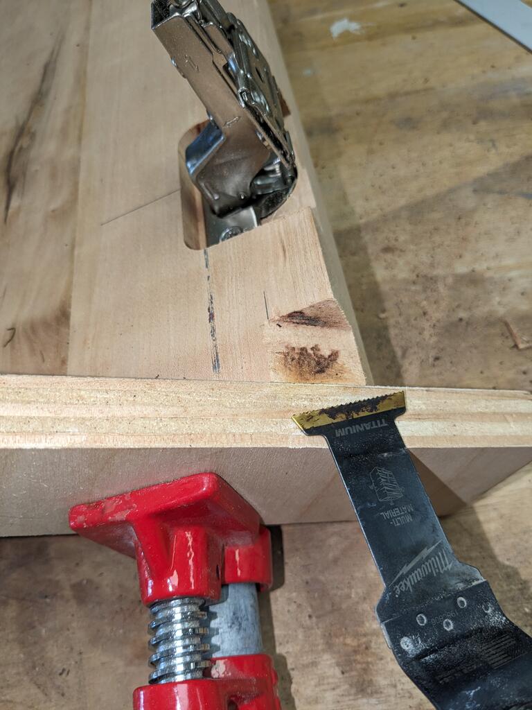

        The trim all the way around is flush with the bottom of the lids, and the lids rest on the trim. When I fitted the lids it became apparent that since the hinges were recessed, the bottom back corner of the lids was going to catch on the trim and keep them from opening. So I had to cut a notch on each corner:
        I just clamped a piece of plywood on for a guide and used an oscillating tool to make the cut. After I was done I realized that I could have just cut a bevel across the entire back with the table saw, that would have been neater and I think might have been a more interesting look. The bevel would have been flush with the routed area.

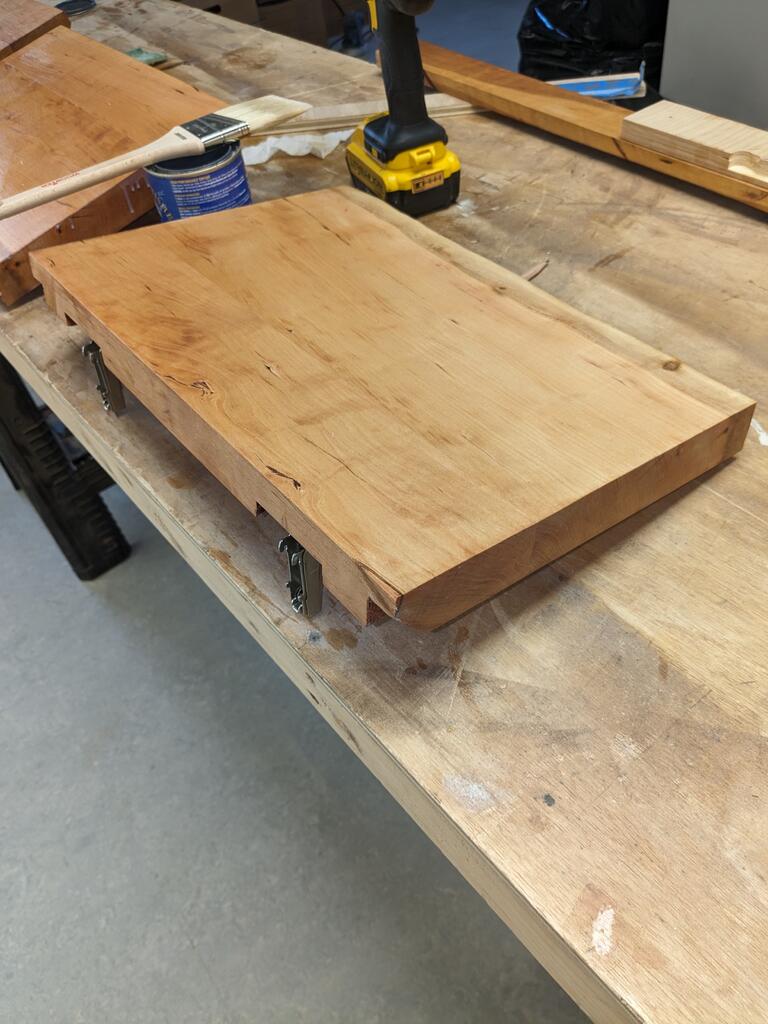

          Final step was to sand everything and finish with General Finishes water based poly, my new favorite.
          I finished with the hinges on, that way I could set the doors to dry resting on the hinges and a pencil under the outside edge.
          Note that this piece has a bit of funky grain on the corner closest to the camera. During finishing that piece broke off, I glued it back on and held it with masking tape while the glue dried and it looks the same.
