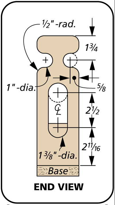

    I was goofing around the shop and made this from an article I saw online -
    I have a Arrow hot melt glue gun that I hate because it has a built in stand but its too narrow and falls over from the weight and stiffness of the cord. It just would not stand up.
    Click image for larger version  Name:	P4220010.jpg Views:	0 Size:	121.1 KB ID:	854911 Click image for larger version  Name:	P4220011.jpg Views:	0 Size:	123.7 KB ID:	854912
    also in the pics/attachments are the Woodsmith article I stole this from and simplified greatly.
    Didn't need the fancy "T"-handle (just a hole for me) and no glue-stick storage.
    This gun had a long handle so I had to make the hole/slot shorter so the gun would "hang" right.
    article link https://www.woodsmith.com/newsletter...ource=hs_email
