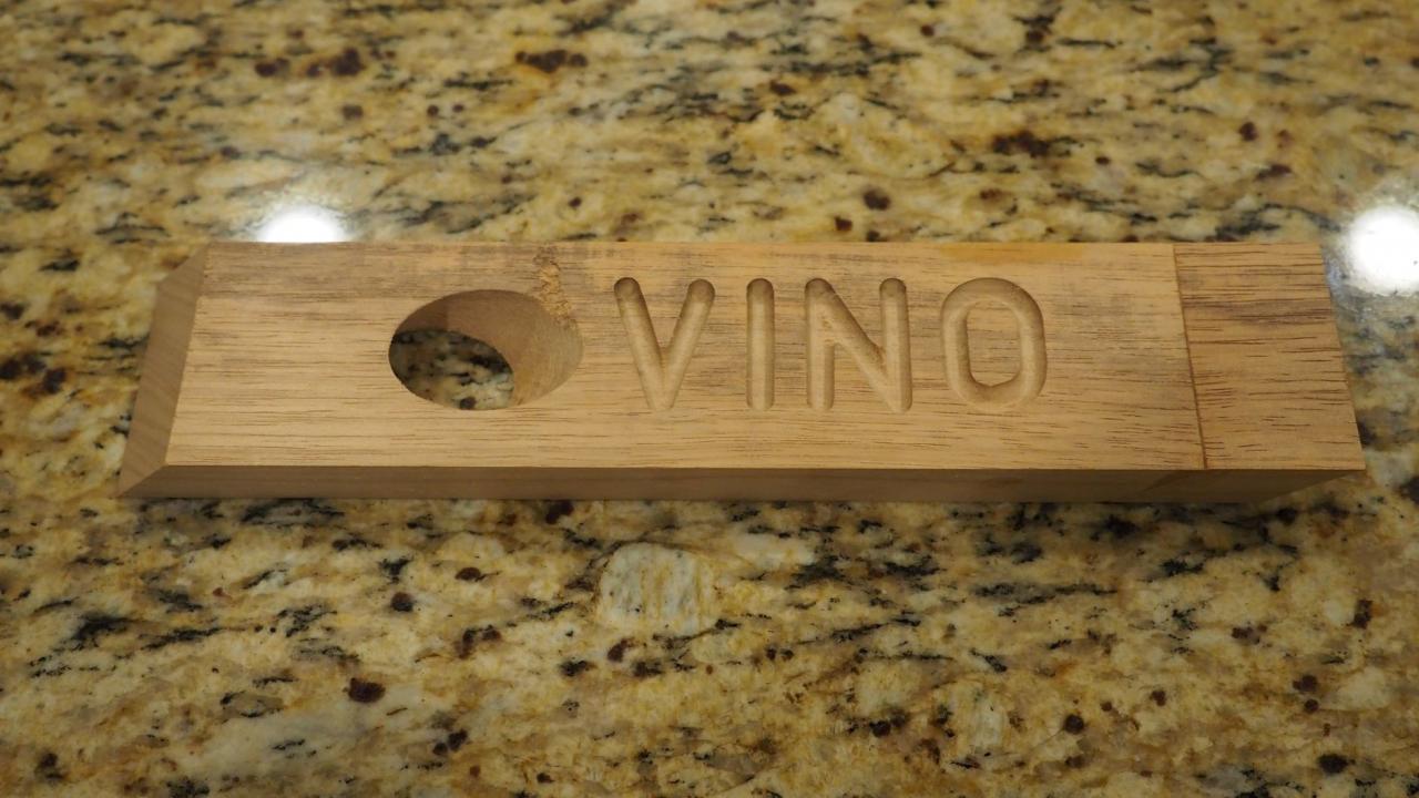

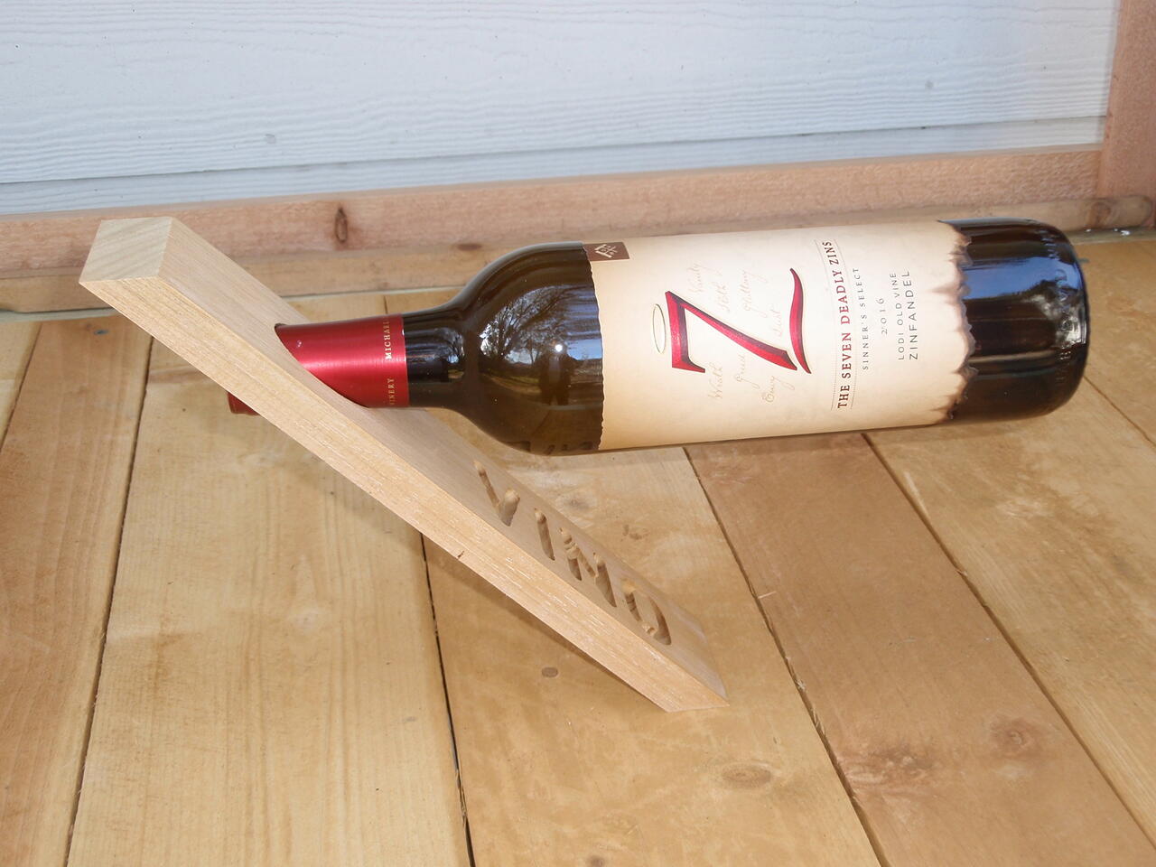

    I was going to make one of these as a Christmas present but it all went wrong.
    They described it on a Lee Valley video they sent me in email. So I made it according to their verbal description and it was all off balance wise. Second it was nearly impossible to make a 45° 1-1/4" hole with a hole saw or a Forstner. The edge of the bit hit the wood before the center pilot drill (hole saw) or center point (Forstner) dug in sending the workpiece flying away catastrophically.
    Click image for larger version  Name:	Wine bottle holder.JPG Views:	0 Size:	98.0 KB ID:	841808
    Other versions I saw they drilled a straight hole, not angled but the bottle goes up at a 45 degree angle which looks odd to me.
    I solved the drilling problem as you can see. I'll explain it in another post if someone wants to know. And I had to splice a piece on the bottom end to get it to balance with all the bottles of wine I possess.
    And just in case the owner forgot what he was drinking, I put some Italian words on it.
    So this is the prototype with a gouge next to the hole and an extension piece, but it does work neat and looks cool. Didn't make it out as a present though.
    Maybe the balance is not all the fault of the Lee Valley design... I made it of 2.5" wide instead of 3.5" wide board as they suggested, maybe the extra material made that much difference.

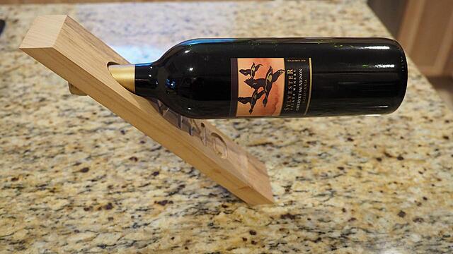

      Finally Completed this project. with a clear acrylic coat.
