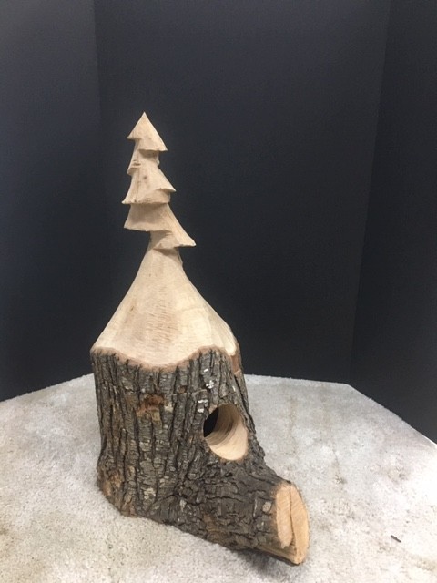

    My wife wanted some new bird houses for the yard this year so I did an adaptation of a band saw box and a Tiny Tree. Relatively quick and easy to build. I roughed the out the tree with the band saw and shaped and finished it using the Merlin II with the chain saw disk. The house part was sawed off/band sawed out the center and saved the bottom and screwed and glued too back to the bottom of the tree section. The bottom is removable for housecleaning and possible attachment to a pole.

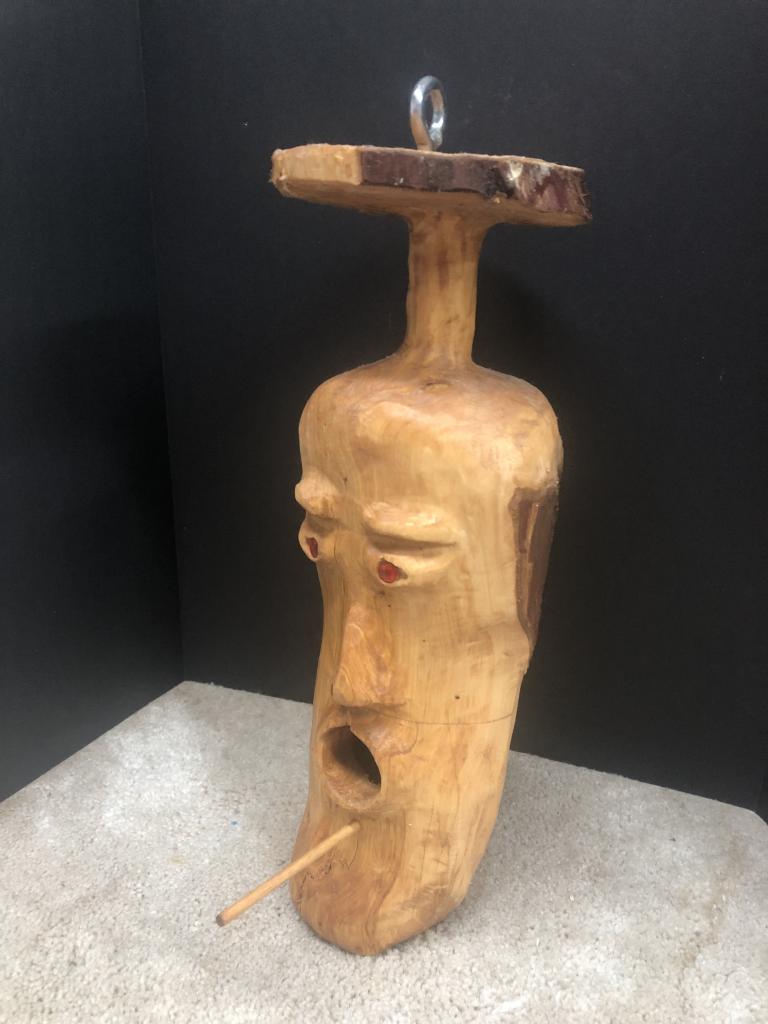

      Maybe she would like my version of the bald headed wood sprint bird house. I’m going to work on the mushroom growing out of his head a bit more. I made this using the Merlin II grinder with a 2” chainsaw disk and a 5” angle grinder with a 4 1/2” chainsaw disk. After I sent the photos to my 2 boys one sent me the utube link to Stubby Nubs where he was showing him using an angle grinder with the chainsaw disk and it got away from him and cut up 4 fingers. A real scary accident. I may do as he says....
      when my fingers heal up enough that I can hold a wrench I’m taking that chainsaw disk off and throwing it in the trash. It may be good advice.

          Okay, I watched Stumpy Nub's video you referenced. Rather horrifying. Thanks for that reference - important safety concern to know.
