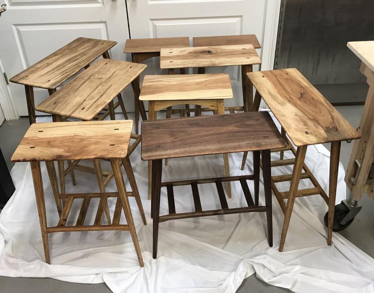

    I've been buisy, dragging this build out for 3 months. Each table is different, even the leg lengths are slightly different. Standardizing the dimensions would reduce the build time.... but it wouldn't be a challenge anymore. I usually build one at a time, but this time I built the last 3 ambrosia pecan tables at the same time to change the pace. Three of these tables are to re-.stock the gallery in Fla and the remaining will probably go to a new outlet nearby.

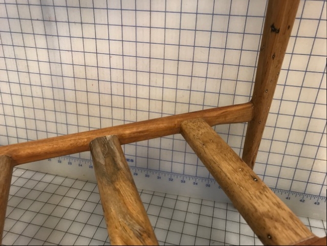

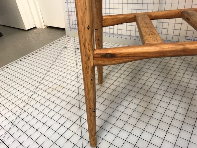

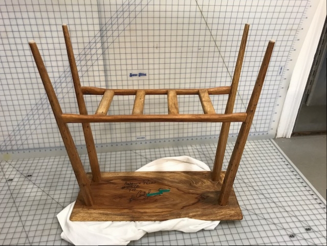

                  Photo of close of of the ladder shelf. One issue with building small components like the ladder shelf is deciding on the rung size and spacing. I've found out that regardless what size and spacing you like, you still have to make it work with the tools you have on hand. That means that if you build the ladder with rungs that are too close together you can't easily sand and shape them with regular sanders. Lots of discovery in building stuff like this.

                    Lee, I constructed the ladder shelf out of rectangular stock that was cut to fit the legs. The leg angle is 5 degrees and the leg bevel is anybody's guess, somewhere around 3 degrees, so the ladder rails are tilted bottom out at 5 degrees and the ends are cut to match the around 8 degrees leg. Each slat is cut at 5 degrees. Clear as mud? The ladder is fitted with dominos and all is glued up, Then I half round everything on a router table, being careful not to route the rail ends at the legs, that is hand cut to make it flush with the legs then sand everything to make it flow together. A 6" sanding paper disc on the 5" ROS has enough paper overhang that it will blend in corners and joints nicely.
