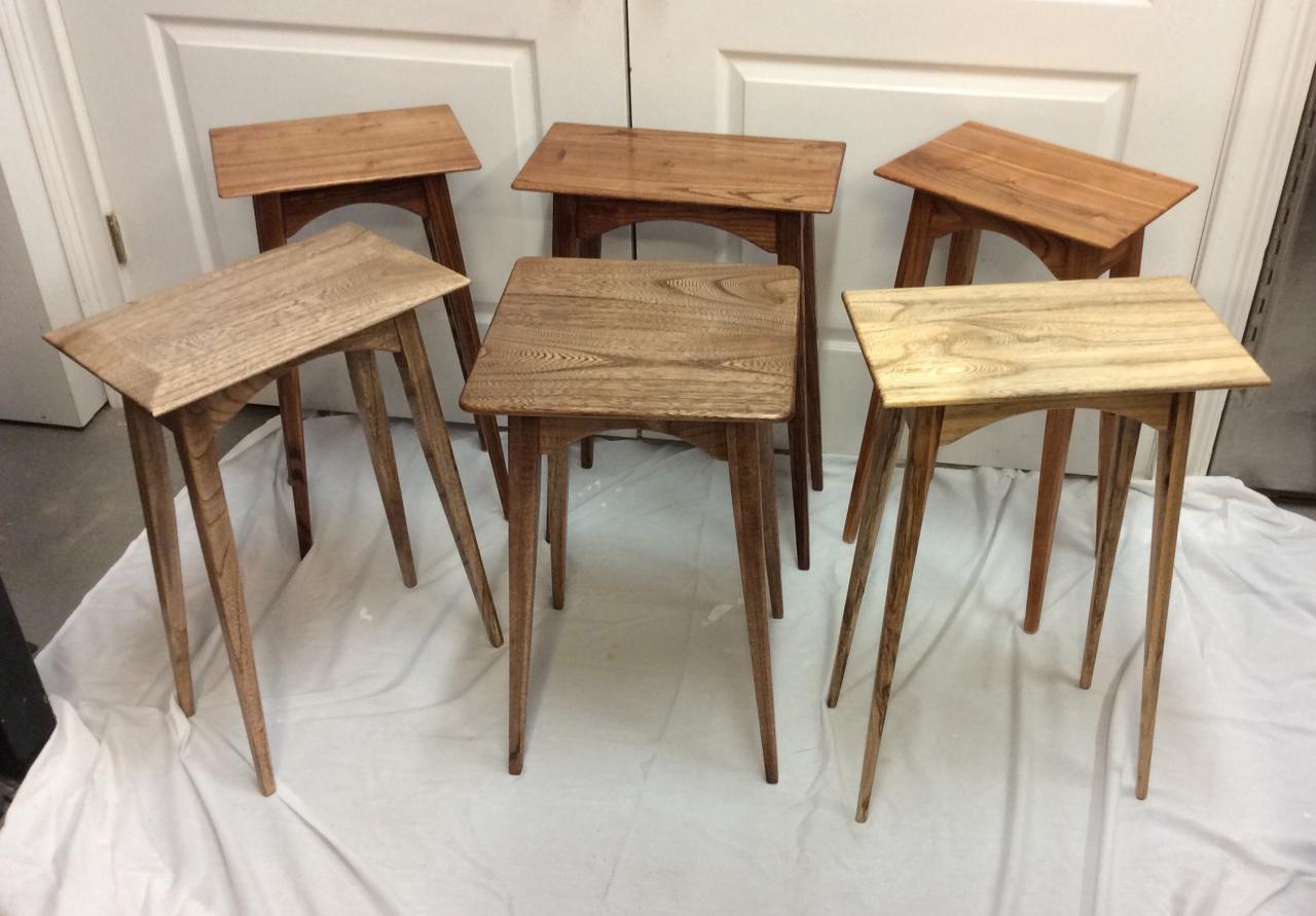

    My Tiny Tables have been selling quite well at the Bowery art galley in APALACHICOLA fla. Now I am in a rush to re-stock with quality tables and highly figured wood to keep the standards up. For the black gum Tupelo Tiny Tables I worked on 3 crooked, warped and cupped Black Gum Tupelo boards that I was able to mill out enough scantlins to cobble together 3 more tables out of these beautiful boards. I think that I have enough black gum Tupelo for 4-5 more tables, then it is gone, gone, gone. The 3 chinaberry tables are made from wood I aquired from a stack of siding wood that was cut from a farm that was clearing wind rows. It works great and warps and twists a whole lot less than the black gum! I probably have enough for 6-7 more tables and this supply is also gone. I'll have to find more highly figured wood to build tables then. The bad thing is antique pine tables sell best, is the easiest to find, but is the hardest to work with, my last choice.

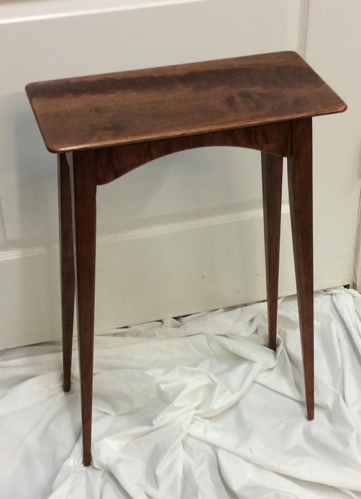

      Cherry sells quite well but my materials cost is sky high. The last highly figured cherry I purchased cost $90 for about 12 bf of finished wood. Not much profit left after I drive 400 miles. Click image for larger version

        Oh man those are nice! I still got some cherry around, Rockler sometimes sells it for $2/bf here. If I ever find some shop time, I will take page out of your book and try one of those.

          gerti, go for it! I encourage everyone that wants to build these tables to have a go at it! I'd offer prints but I build these tables from scratch with no real drawings. I start with a nice table top and work down, decide how much overhang looks good with it, then build some legs that complement the top, then build the aprons with the angles to guide the leg splay. They make great gifts and can be crafted from existing wood lurking in the shop. ( takes about 6 bf) and 8-12 man hours.
