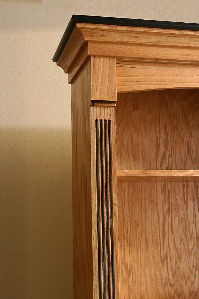

    Full oak plywood case and shelves with solid oak face frame. Top cove molding formed on the table saw. Black inlays in vertical fluting are glue-on oak banding (ripped to 1/4" width on the table saw and individually stained with black India ink before being glued into flutes.) Vertical fluting in face frame cut with a router and jig, the design for which was provided in the Woodsmith plan.)

      really nice work! can you explain again what the flute inlays are. Do you mean the flutes where cut and then the voids filled with another wood so its level with the surface? COuld you post a close up. Thanks

            These cases look really good. I also have that article in Woodsmith marked for future use on tv case I must build sometimes soon, after I build the laundry room cabinets. I liked the detail about the filled fluting but rather than go to that much work was thinking about making that part of the face frame a glued stack up with already stained dark wood instead of inserts, then sand flat like a butcher block. Me and inserts don't have a good outcome.

                The black color in the flutes is from black-stained (India ink) wood banding glued into each flute. Since it's just thin banding it's only at the bottom of each flute. This was a decision I made to eliminate the possibility of ruining the piece if I screwed up while trying to directly apply the ink into the flutes with a thin brush or similar applicator. I also did not want to color the entire inner surface of each flute as that was too much black (test applications revealed that.) So think of what I did as an alternative way of drawing a straight thick black line in each flute. See detail in attached photo.
