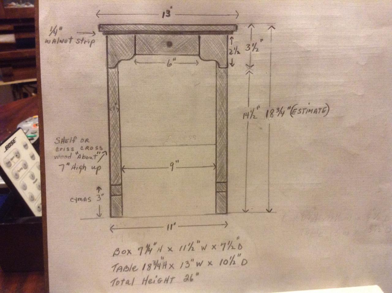

    This was the pic I was looking for to show.

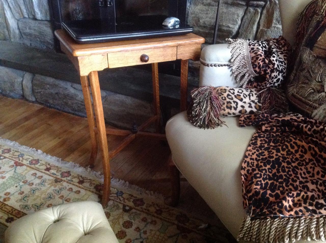

    I really liked this design, but nixed it because it
    mirrored my laptop table to much (in the same room,) and
    even though the legs were very different
    I wanted something that stood up on it own.
    We did made the cymas for the legs, but when we tried
    them out it was too much.The table looked nicer without them.

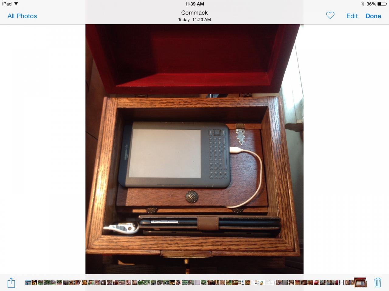

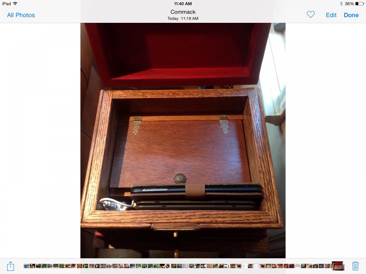

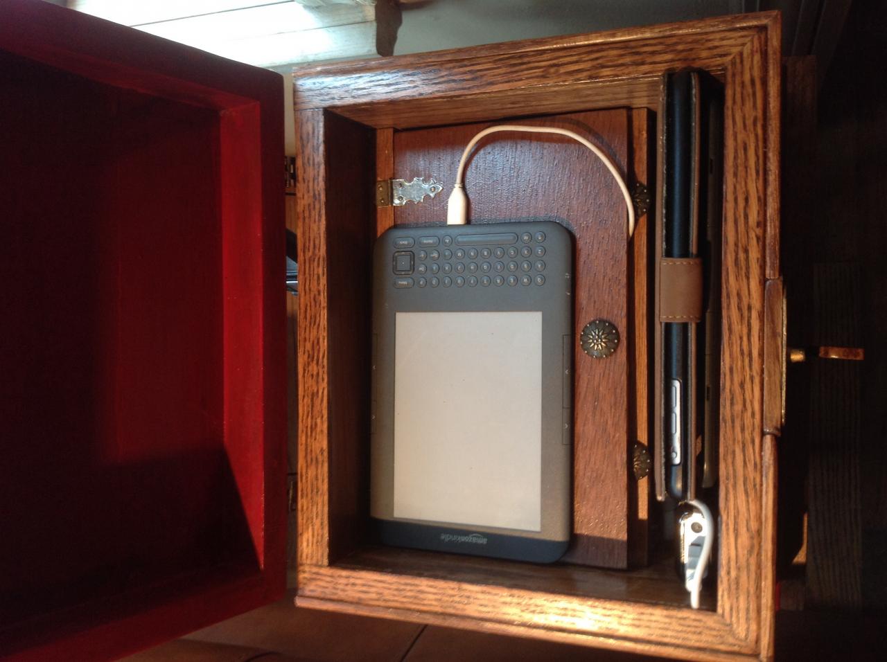

      Here Ya go Radhack. There is a light strip along the back. The hole for the light strip plug is
      on the bottom right side ( that's where the outlet is on the wall)
      The little flip top is just hinged, it does not pop up and down. The divider wall that holds
      up the mini iPad, kindles, and battery pack, slides back and forth to adjust for more stuff,
      if necessary.
      The little brass buttons on the divider and the flip top door are buttons
      from an outfit of mine. I really wanted a little drawer, like I have on the laptop
      table for the extra charging cords...that I probably will never use anyway
      but I thought the drawer was overdoing it -- in this simple little table.
