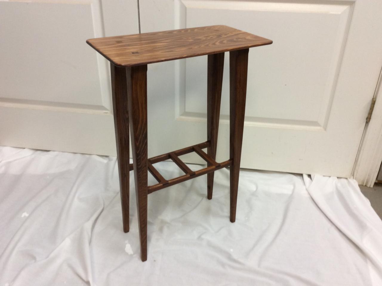

    I have been thinking about building a table of this type for several weeks and decided to go ahead and build one and see how it is received by the customers in Apalachicola. I just finish waxing the first tiny table III. The wood is cypress, sinker cypress, from Swindells Cypress Sawmill in Perry Fla. It was inspired by a table I saw in Vancouver, but not a copy. This one is the same dimensions as most other tiny tables because I already had a top cut out and ready to go. It's also a couple of inches taller, 26" It's the first tiny table to have a bottom stretcher and not to have any apron under the top. Also, unlike previous tiny tables the legs are doweled through the top with square pegs. If there are any future tables along these lines I will make the top larger, probably square with the legs longer and skinnier.
    capncarl

    Beautiful table and design!

      Very nice table. I would be interested in learning about the procedure for the "square" dowel installation.
        +1
        Great looking table.
          Great looking table, I like stretcher details. So the legs aren't through-tenoned into the top?

            Good looking table. I like the dimensions of it

              My apologies for not providing prints and details of these tables. I have a poor excuse of not having enough time and I'm playing that card again, sorry, I'm working on it.
              The photo does not do this wood justice as the top, legs and stretcher are made of all the same wood and stain, but in the photo the legs and stretcher looks almost black.
              I wanted to thru tendon the legs. The legs are a compound angle, 3.5 x 3.5 degrees. I tried to cut a stop tennon on the top of the legs with this compound angle and came out with a lot of scrap. Instead I cut the top of each leg 3.5 x3.5 degrees and cut a 1/8" square mortise in the bottom of the table for the top of each leg to set in and drilled a long screw into each leg from the top. This positions the legs well and allowed me to build and fit here stretcher properly. Finally I removed each leg and glued it back in its mortise and screwed it back. After the glue dried I removed each screw, bored a 1/2" hole down the screw hole into each leg, created a square mortise with a chisel and fitted a 1/2" square 2 1/2" long dowell, sawed in a wedge slot and mopped in a generous quality of glue, then pushed in the dowel and expanded it with a wedge. Each leg dowell takes about 20 minutes.
              I hope that I have time tomorrow to visit Cordrays Mill Sawmill. They have antique sinker pine and cypress and specialize in supplying wood for very high end constructions. Maybe I can leave with a small quantity of highly figured pine and/or cypress.

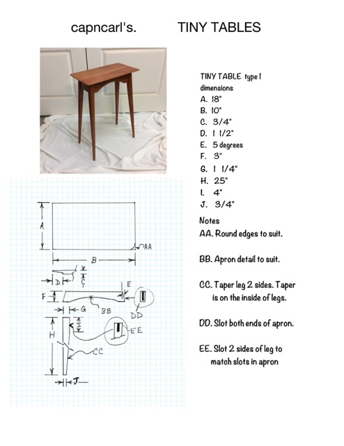

                Didn't get to make it to Cordrays, maybe in a couple of weeks. I used my time to cobble together a drawing of the tiny table.... I miss me some acad, really bad. It contains most of the necessary info. And wouldn't you know it, this drawing is of the type 1 table and the one in this post is a type 3. Oh well, I'll get right on it.
                capncarl
