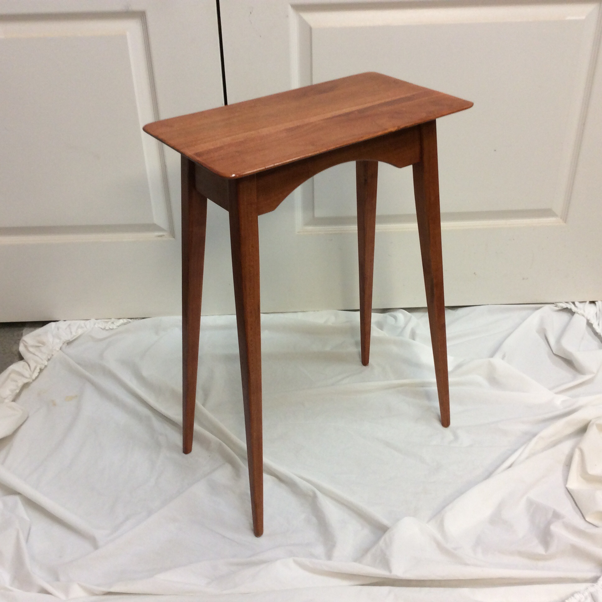

    Photo of my latest Tiny Table made from storm damaged cherry.
    First, I apologize for not posting plans and dimensions of this table like I promised, but I've been buisy, but will get it done.....when I figure out how!
    Most every table I build I try something different, recently I have been applying a shelac seal coat before I wax the table. This table I changed my wax brand to Miguires gold class. I think I like it.
    I've got to get to work making usable wood out of the stack of cypress and pine I picked up last week, that will take about a week, then I will change my table size and design some more.

    Very nice looking and work. I have probably 200 - 300 bf of cherry just waiting to be made into something like that! Beautiful and well done!

      I can't decide what is my least favorite wood to work with. It's a close call between pine and cherry. Pine resin ruins my sanders and blades. Cherry doesn't have the resin problem but burns really bad causing way too much effort to prevent it and to correct the burns.

        Very classy looking ... beautiful finish!

          Love the splayed leg look. Nice job!

            I fear that someone sits on one of these splayed legged tables like it was a stool and busts a leg, getting a spear somewhere it doesn't need to be!

              Very nice.
              Let us just hope that family and friends are significantly more respectful of your fine work than to attempt EVER to sit on it!

                Looks great! I also really like the finish, did you stain it?If yes, what stain did you use?

                  As careful as I can be if I glue up the tables there will be somewhere that glue has touched a piece and stain will not take. So now I sand all table parts and stain before I glue up. This way I just have to be careful not to get stain on the mortise and tenon leg/apron connections, that's easy enough. ( does anybody know if titebond 2 will adhere to stained wood? Hadn't tried it to see) This saves a lot of time. Any glue that squeezes out on the stain is quickly wiped off with a wet rag and does not seem to effect the finish. I usually apply another stain coat after the glue up because I want it darker. This table has a wipe on coat of shellac over the 2 applications of gunstock color stain. Then a generous coat of Meguires gold standard wax.

                    Excellent work capncarl! I too like the splayed legs.
                      Nice work, simple and elegant.
