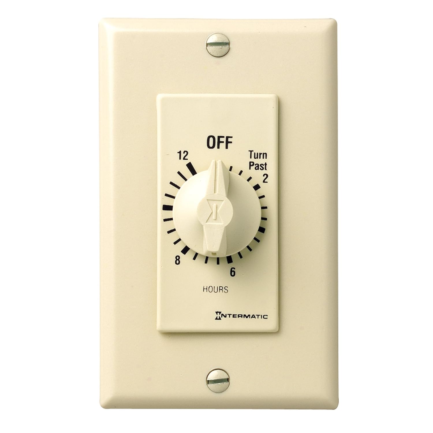

          looks like it needs a 12-hour spring loaded Intermatic timer.
          http://www.amazon.com/Intermatic-FD1...timer+12+hours
          you can turn it on when you enter the shop for anywhere from 1 to 12 hours or so and it will continue to run for a couple of hours after you retire for the day, cleaning the last remaining suspended dust out of the air. Never have to remember to go back out and turn it off.
