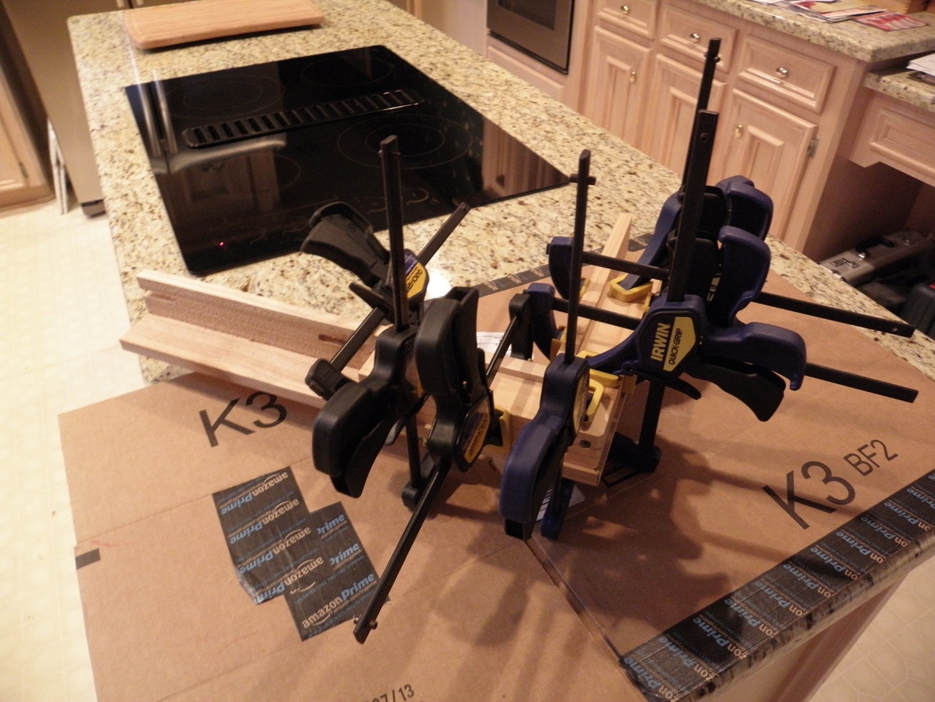

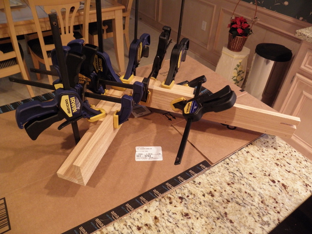

    here's the construction glue-up pictures.
    I had this great idea...
    IT had to be pretty square so I used my homemade glue-up squares.

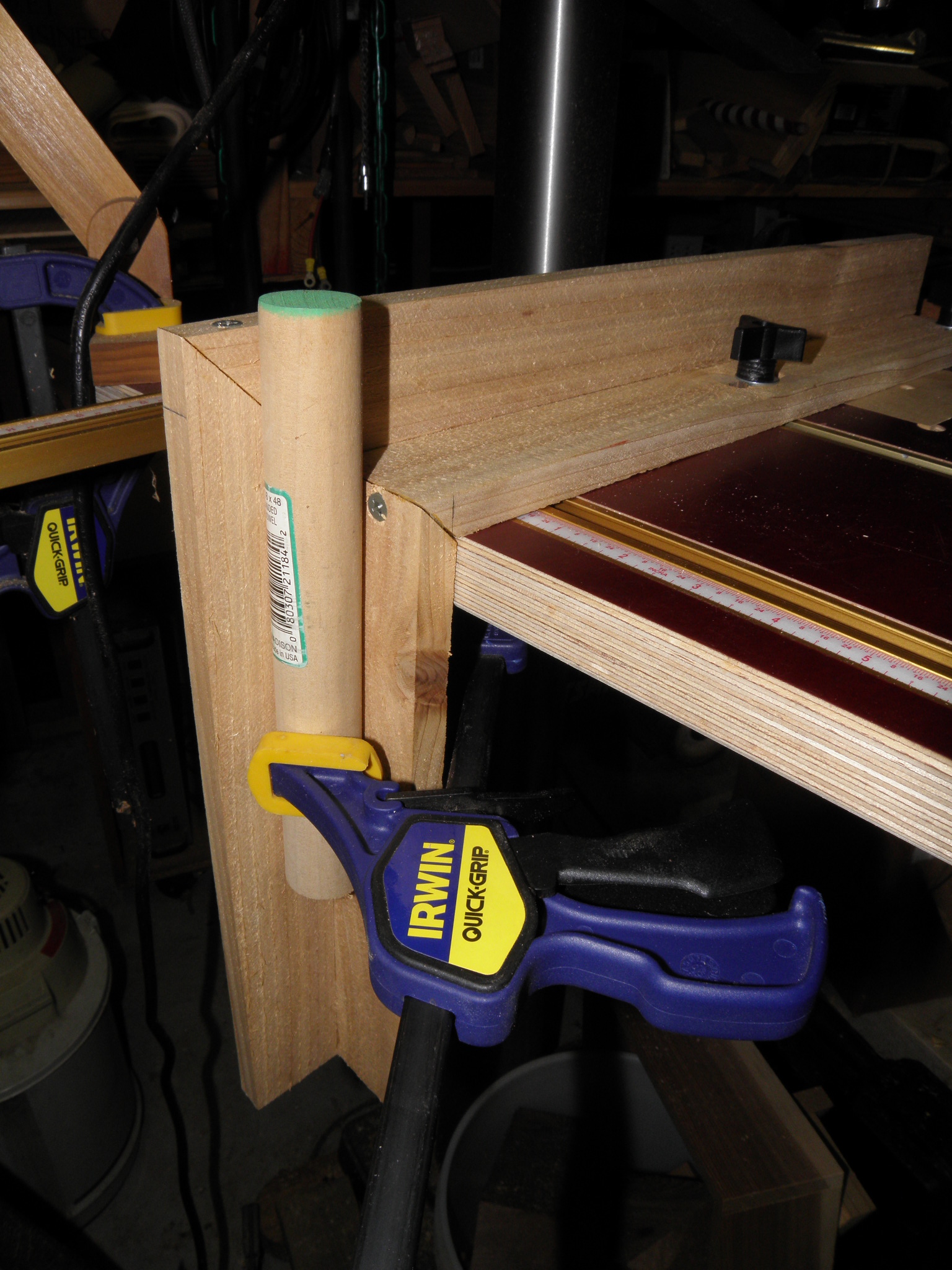

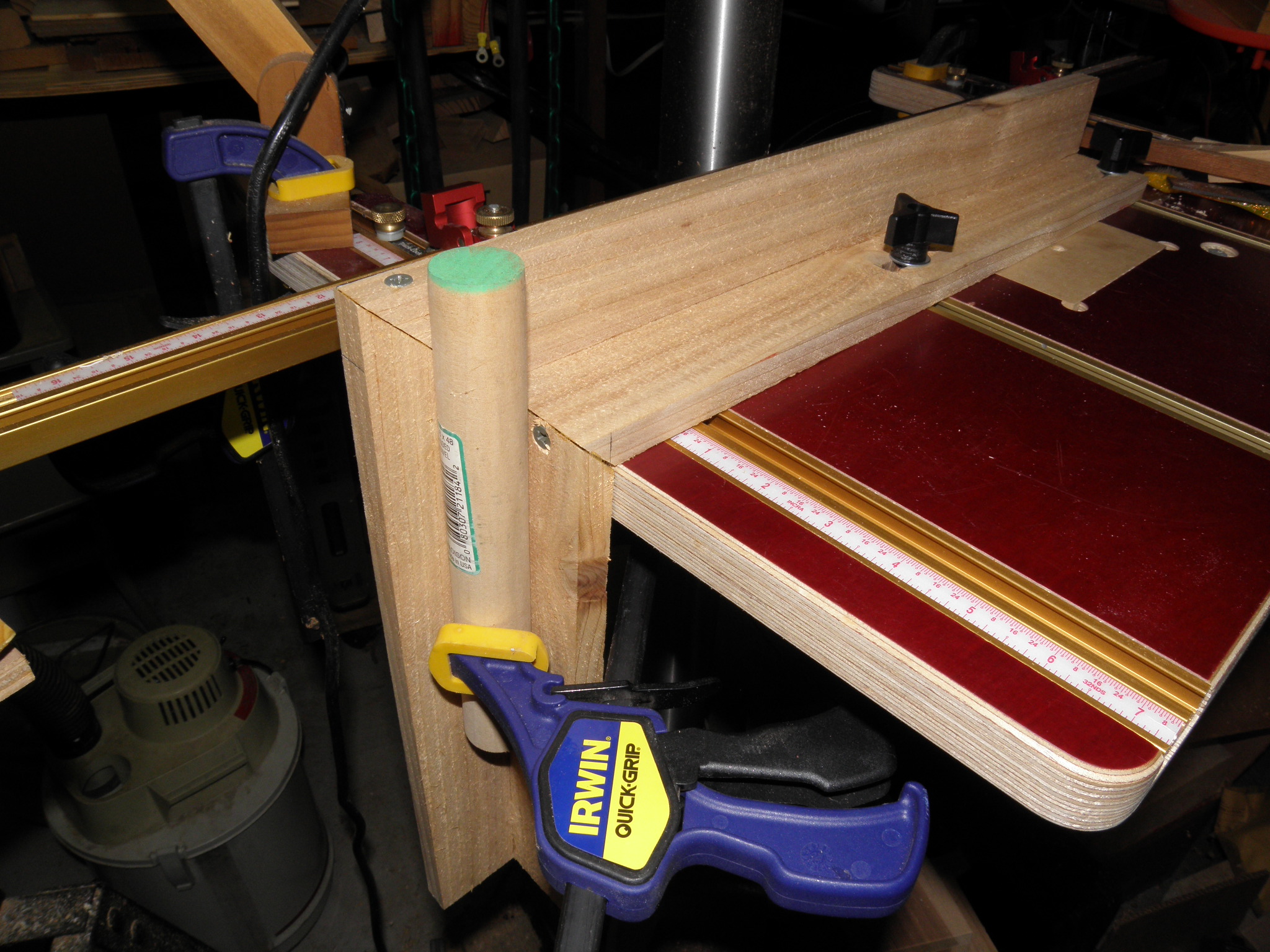

        So here's the mystery project fail.
        I thought I needed a vertical drilling clamping jig and I thought I remembered seeing something like this to hang off the side of the drill press table. As envisioned you would clamp a long board or dowel (lmiited by the height of your DP table from the floor) and drill perpendicularly into the end.
        I built the thing by mitering an angle piece I had left over from some other project in the clamp-up I showed in the opening post.
        Unfortunately I somehow forgot that the distance from the post is limited by the swing size of the DP, and in this case I can't reach to drill off the end of the DP table, without doing some massive rearranging of the way the table is mounted.
        So, no vertical drilling jig...
        Still, it seemed like a good idea at the time.
