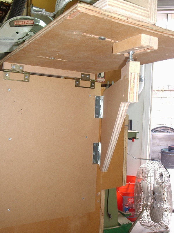

            Hi Protool! I've just about finished my version of your setup. Thanks for the great pics! They've really helped in getting this together.
            I have a few questions regarding the adjuster for the wings. There is a bolt on the support which is let into an insert. There is a block on the underside of the wing which rests on this bolt. Is the bolt a carriage bolt? Is it intended to rest in the groove on the support block? Do you find that this provides an adeqate connection - i.e. does it stay in place? Do you have any advice on how to best implement this thing?
            TIA
                TIA
                JR, I updated the blog post a few days ago with shop drawings. It got featured on Kreg's facebook page last week and people came out of the woodwork (ha!) asking for drawings. Anyway, go look at the post again - there may be some more clarity there for you. http://davidcox.org/wood/folding-rol...hop-saw-stand/

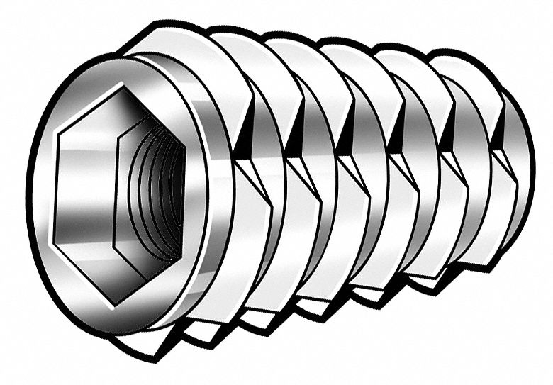

                You are correct that this is a 1/4-20 carriage bolt. On my stand, its probably 2" long as a good bit of it is buried in the wood. I installed a brass threaded insert to receive the bolt along with a wingnut and washer to lock it.
                I was not able to use anything larger than 1/4-20 because my hinged wing support is only 3/4" thick. I'm not too worried about since the insert is threaded into hardwood. However, if it was just mounted in the plywood, I don't think it would be substantial enough.
                Yes, the carriage bolt rests in a routed groove on the support block. You can see this detail a bit better in the new shop drawings:
                I have had no problems with this being substantial enough to stay in place on the chop saw. If i were to rebuild it though, I would make the routed groove deeper so that the entire head of the carriage bolt is buried into the groove. On this chop saw stand, I've never had it jump out. However, on the planer stand I mentioned a few posts back, it has wiggled out of its slot once or twice during use.

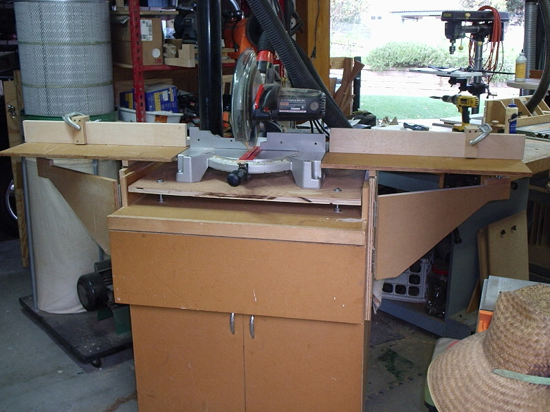

                        I'm finally done with my mods. Since I'm pretty much copying protool's design I won't start a new thread.
                        I used as much material from my shop as I could. I spent a total of ~$15 on hardware. The wings are repurposed from the old design, so the 2' length of the wings was predetermined.

                        The wings are made of 1/2" plywood, which means that t-track was out of the question for the fence adjustment mechanism. I cut slots all the way through and used carriage bolts to hold down the fences. I couldn't pull the trigger on the Kreg system, so I implemented my tried and true c-clamp-and-a-thingy method for stops.

                        The landing place for the wing leveling adjusters was centered on the wing and installed as far out on the wing as possible. I was hoping for extra stability with this setup.
