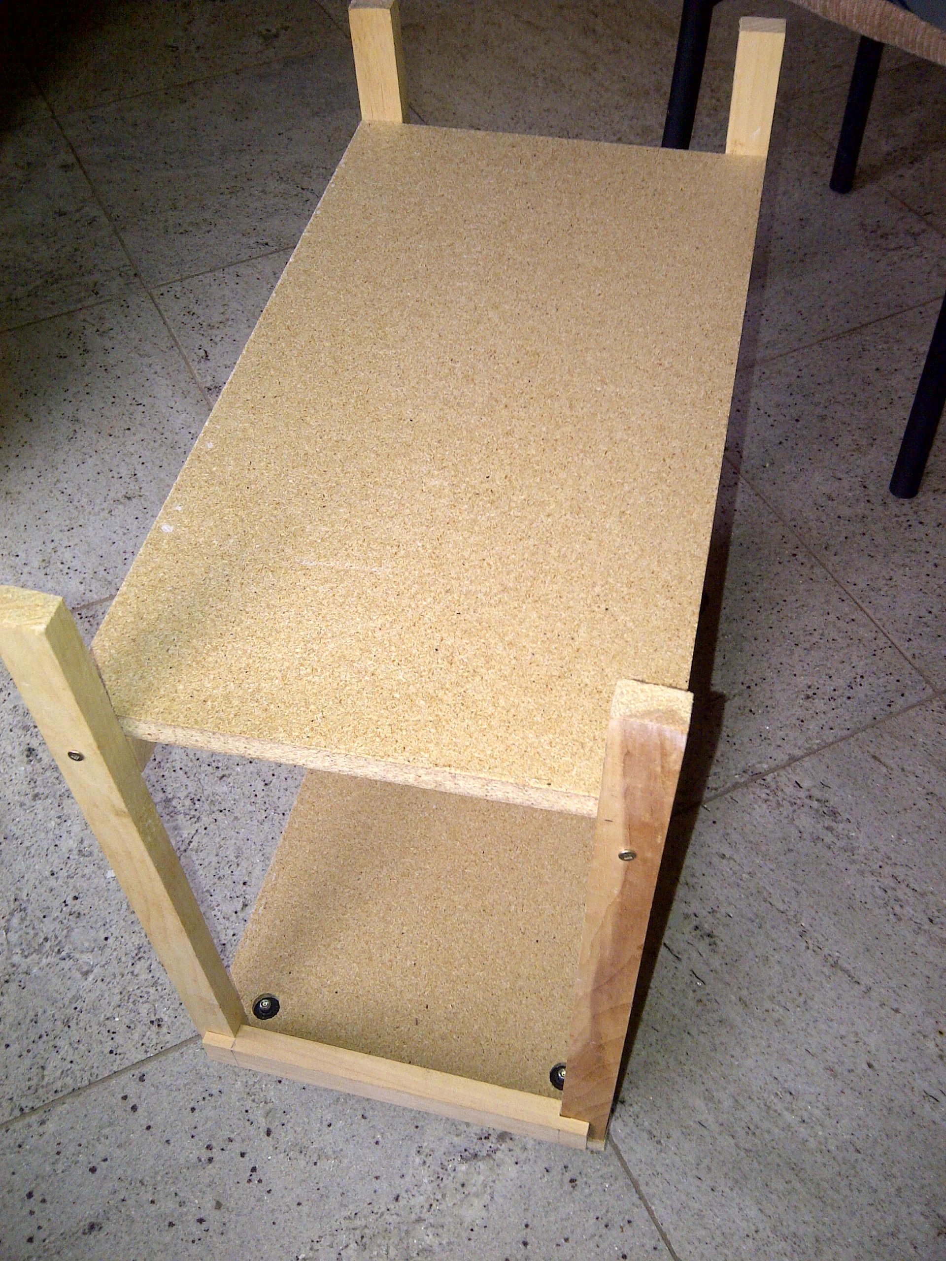

    The attached two are my first 2 projects. Your comments are appreciated.

      Nice work, you are on your way now. Just a little tip, on legs such as your shelf unit, a slight chamfer or beval all the way around on the bottom will help prevent the leg from splitting where is contacts the floor, will look a little fancier too.

        I'm not sure what your second picture is showing. The first picture being a very nice looking small white table is quite nice though.
        But the second picture looks to me, like you are fastening your "legs" into what appears to be the edges of "chip" or "particle" board. If that is the case, my experience tells me that will lead to some problems, as there is very little integrity and strength to such. (But, you may have a horizontal piece of solid wood running underneath the edges of the flat... I can't tell by the angle of the photo.)

              The second is a rolling cart which hides under the dining table (it is a granite nonmoveable table) and will store bread maker and waffel maker). Will not carry too much weight. The wood was a 1 x 8 by 3/4 and the casters were found at home).
                      Take a closer look...
