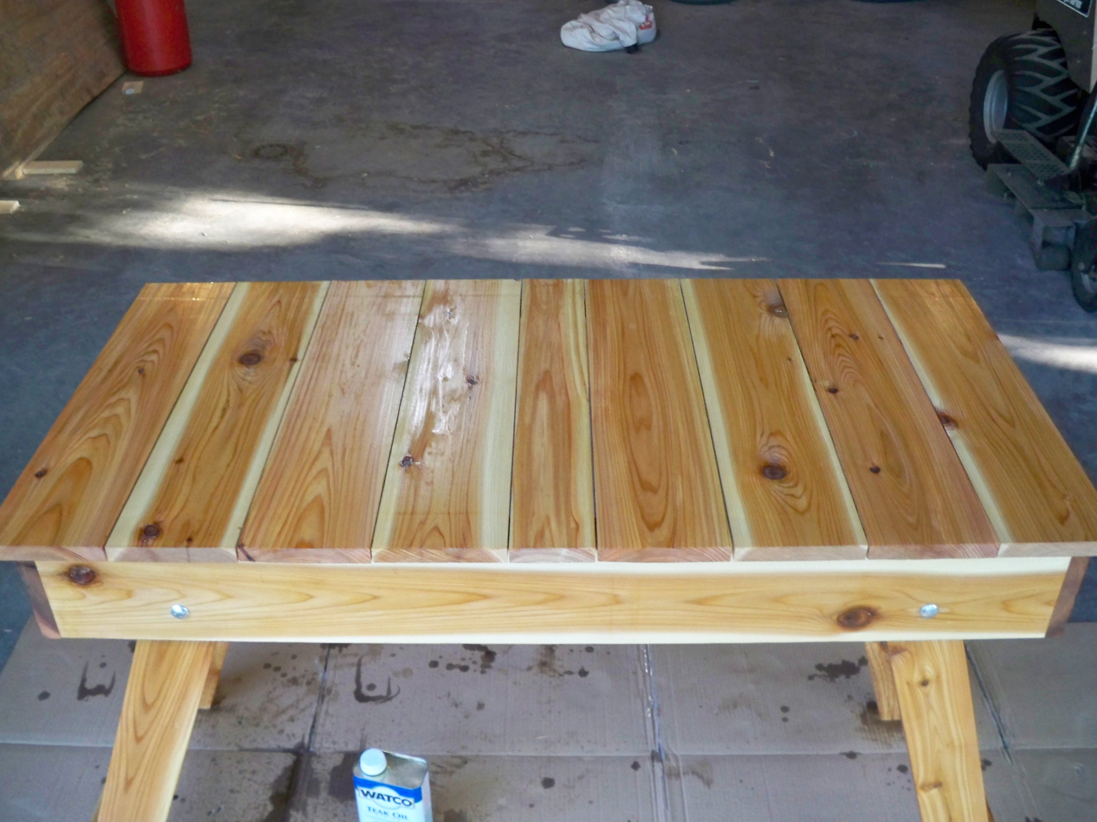

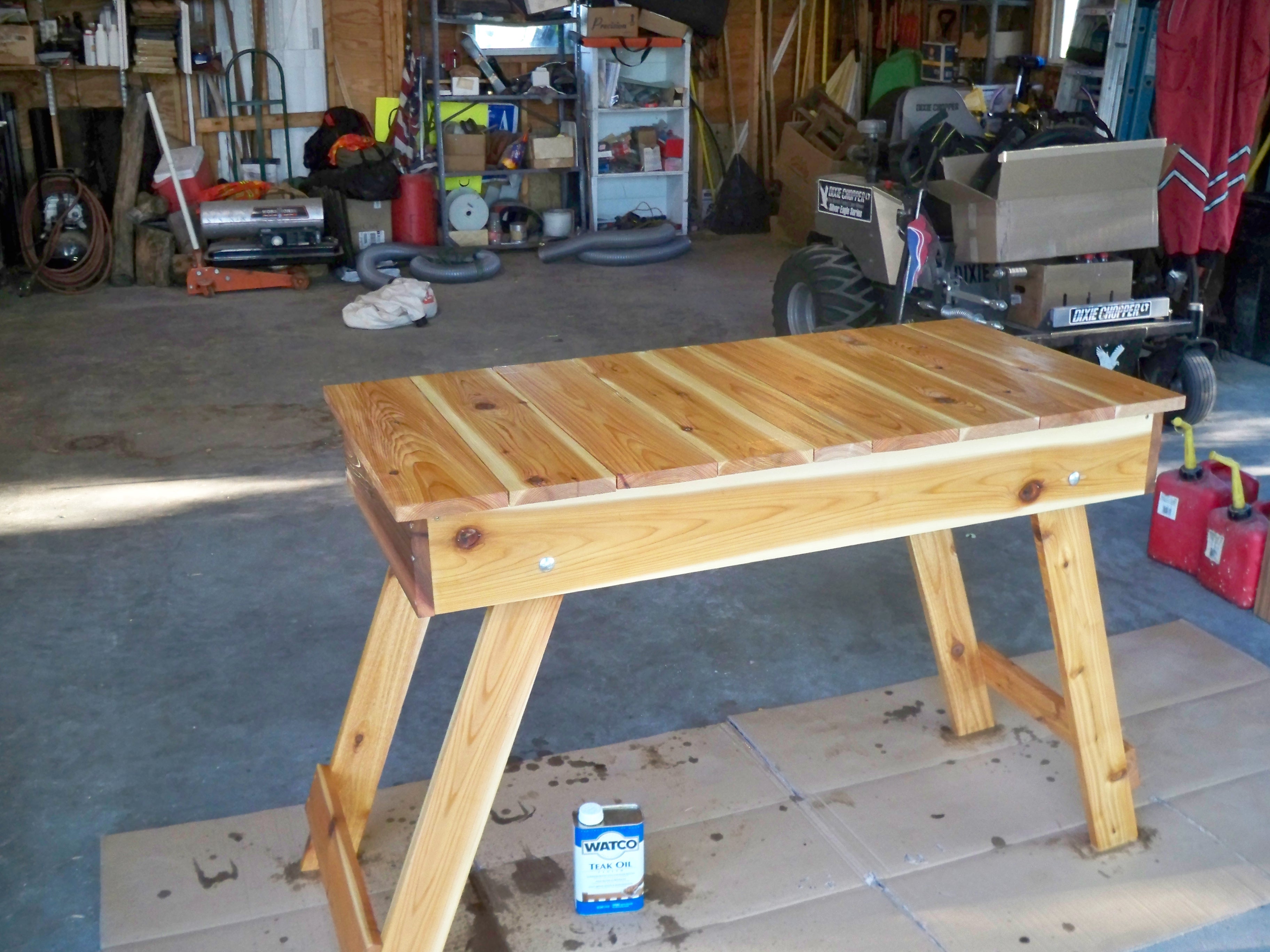

    LOML picked up a few project books over the winter, and as i browsed through a folding grill table caught my eye. Last week she asked if i could build a table that was a better height than the one on the deck and since i had some cedar on hand that i was going to make some window boxes out of...i set to it.
    Plans were for 42 x 19 top with 28" legs, but that would have left it the same height as what she had. I redrew with a 48 x 24 top so the legs coud be longer and finished about 1" lower than our kitchen counter top.
    Instead of screwing down through the cedar to attach the top, i added cleats to the inside of the top skirt (right term?? Wrong term??) so i could put the screws in from the underside. Three coats os teak oil on it and i'll follow with a hand rub and maybe a coat of wax.
    Was the first time i radiused for folding legs (Pillsbury frosting container is 3 1/2" diameter--perfect!! Progresso soup was only 3 1/8". Someday i'll buy a compass...) Worst thing of the project is that the deck is 15+ years old--the table needs to weather quickly or she'll put a new deck on the list!!!

        The table came out great. Cedar was a good choice. If you used that Watco on it, that's an oil/varnish mix, and if you can keep the table covered the finish will last a lot longer. It's not just a true oil. I wouldn't use any wax of any kind.

          Thanks Cab--finish dried nicely overnight. Don't think there's need for anything else.

                Nice job, and good call on hiding the top fasteners. I really do like the look of the ceadar board top with the sapwood edges and irregular widths. I second the no-wax application, and definitely no poly. Using just the oil, touch up re-applications will be easy.
