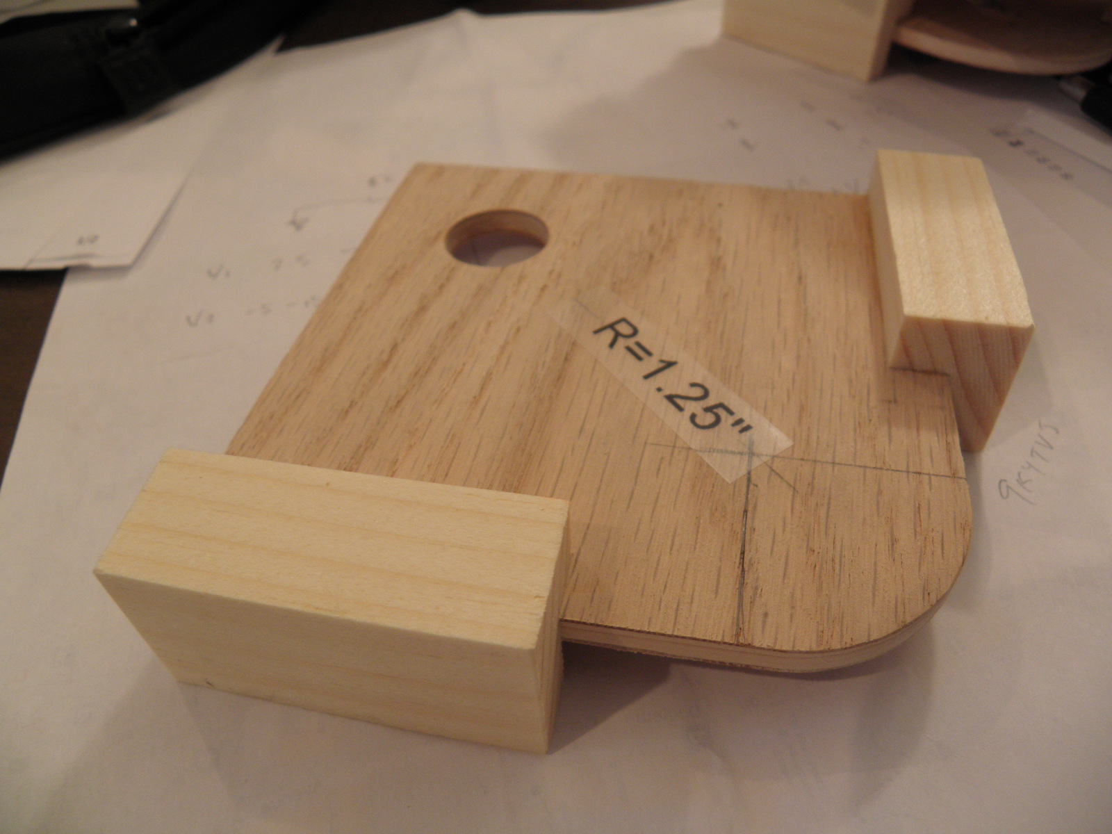

    I always marked corners using a marking template like this but it required freehand final sanding with a spindle sander which one slip could ruin the piece and always required steady hands and patience.
    I made my templates described here using the marking template, so I was required sanding once forever after rather than four times for every work piece.
    Yeah the Commercial templates are nice and precise, but my marked and sanded corners were always good enough. And, the Woodpeckers had 2 radii per template but only 1/8" difference... I would think 1/4" steps would be good enough and wished they had placed wider spacing on the same template... such as 3/4 and 1" and they could have put 7/8 and 1-1/8 on another template for those wishing smaller steps. To cover 1/2 to 1-1/2 have to buy 6 templates for about $155 with 1/8 inch steps, or three with 1/4 steps and they could have made another 3 with 1/8" in-between steps for those that wanted them.
    Here's the results of my build (set of 5 with 3/4 to 1-3/4 by 1/4") for use with a 1/2" top bearing flush trim bit:
