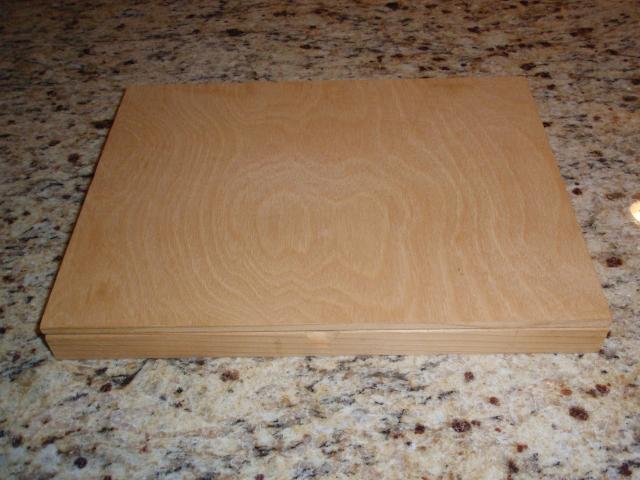

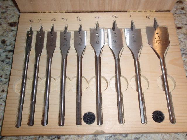

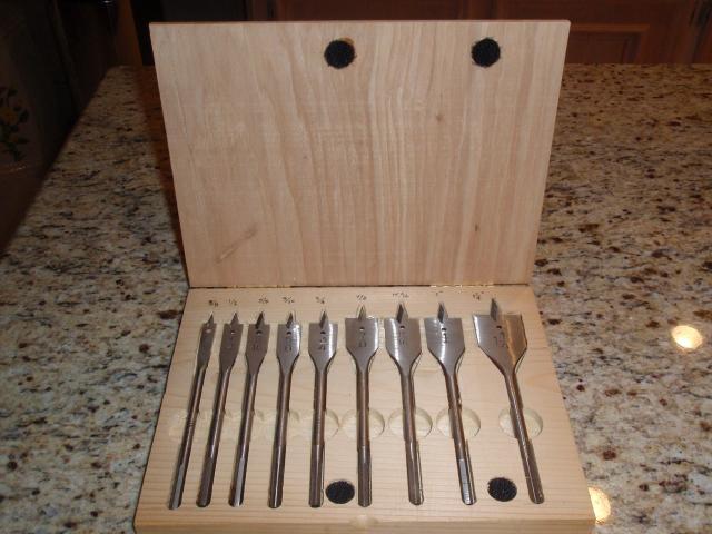

                spade bit storage
                Yes, that storage method does look real dangerous....
                made this spade bit storage box a few years back...
                used a piece of 1x8 and a piece of 3/16 plywood, some hinges and a couple of countersunk velcro circles to latch the lid shut.
                Hogged out with router, chisel and probably some forstners.
                Here's the simple plans:
                Sort your bits, make a table of the widths, add 1/8" between them. Allow 1/4" at the edges, make a table of the box edge, location of the center of each bit, leaving 1/8" plus half the width of each bit between them. Then add 1/2 the width of the largest bit plus 1/4" and now you have the length of the board to cut.
                Draw the lines make sure everything will fit, drill the finger lift holes with a 1" forstner 1/4" deep before you lose the centerlines.
                Use a 5/16 router, make a bunch of blind 1/4" deep, fence guided, stopped dadoes from 1/4" from the bottom to about the length of the shank.
                Lay each bit in the slot, the head won't go down but now you can trace the outline of the bit.
                Use a router handheld to hog out most of the head area, then come in with a chisel to finish the tips and straighten the edges. Depth of router for the heads is less deep than the shanks.
                I didn't plan for how to close it until the end and did not leave space for velcro and had to put them where it fit. I drilled a small 1/4" pilot hole and used a center dowel locating thingy to put a dent in the top, then used a forstner to drill sunk holes for the velcro, the sunken hole in the top being just enuf to locate the velcro pad. The finger lift indent in the middle of the front edge, just use a half round ******* file.
