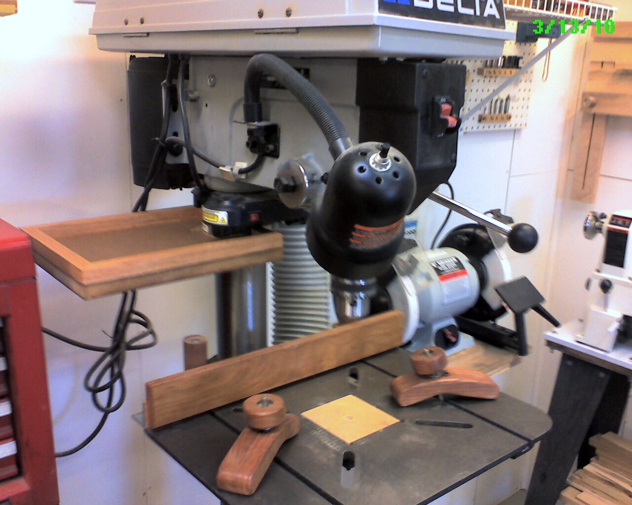

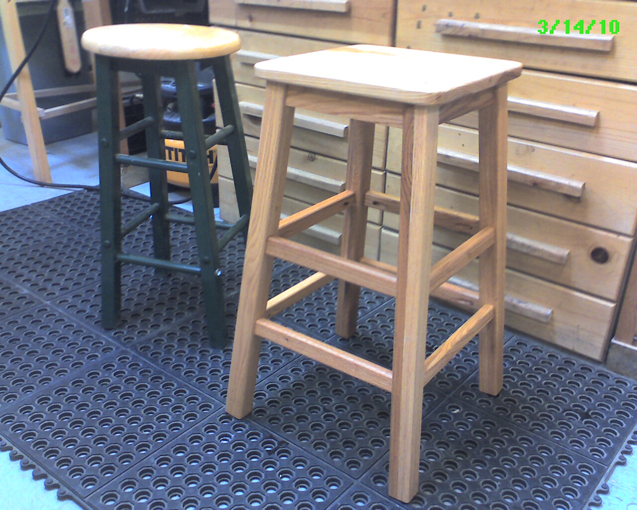

    Sometimes I just look around the shop and see what I could use and not have to buy additional wood to build it. I decided on a new shop stool as the one I have been using (WalMart) shifts and creaks. I have also been wanting a place to put bits and pieces while working at the drill press.
    The last picture shows the stool from WalMart. [edit: Sorry for the quality, taken with my phone camera.]

      are those stools leaning or is it an optical delusion?

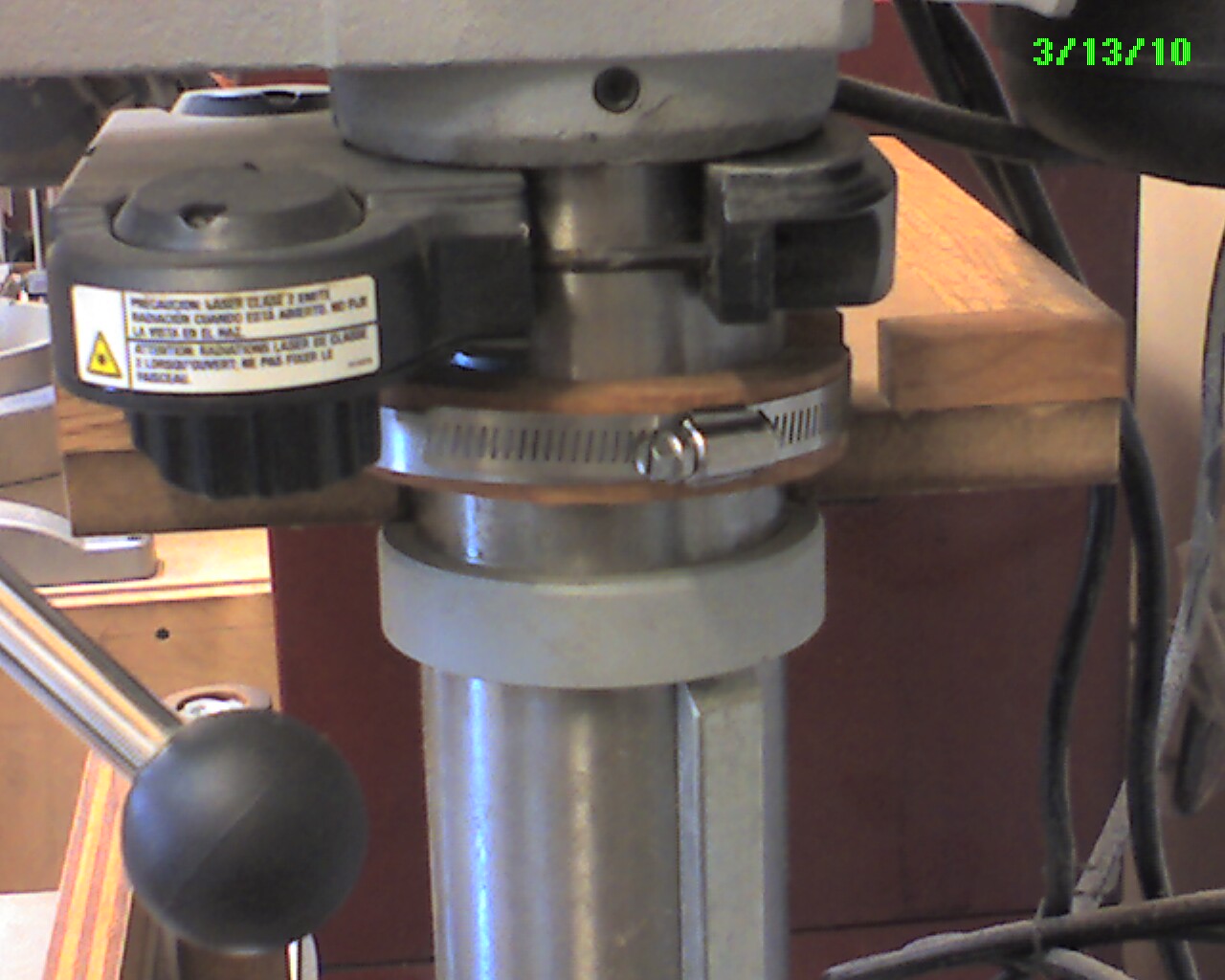

        The DP tray, how did you attach it?

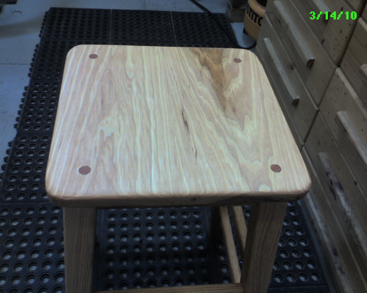

            I'd like to build one at some point. I can see pocket screws in the rails, and through dowels reinforcing the seat to leg connection. It's a little hard to tell, but I assume there's an outward splay to the legs. If so, what angle did you choose to splay the legs?
              I was embarassed to use that picture and sure enough I was called on it. Just the fisheye effect of the phone camera lense.

                Originally posted by dbhost
                Nice work Larry!
                Make a 3" wood circle approx 1/2 - 5/8" thick, cut it into, attach one half to the tray and the other half on the opposite side of the drill press post with a radiator hose clamp.

                  Originally posted by docrowan
                  Very nice!
                  Chris, you are right just pocket hole joints, dowel pegged top and 5 degree angle in two planes. It turned out to be amazingly level and feels very sturdy.

                    5 degrees, got it. Once again, very nice job.
