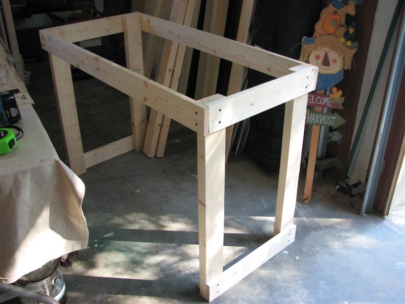

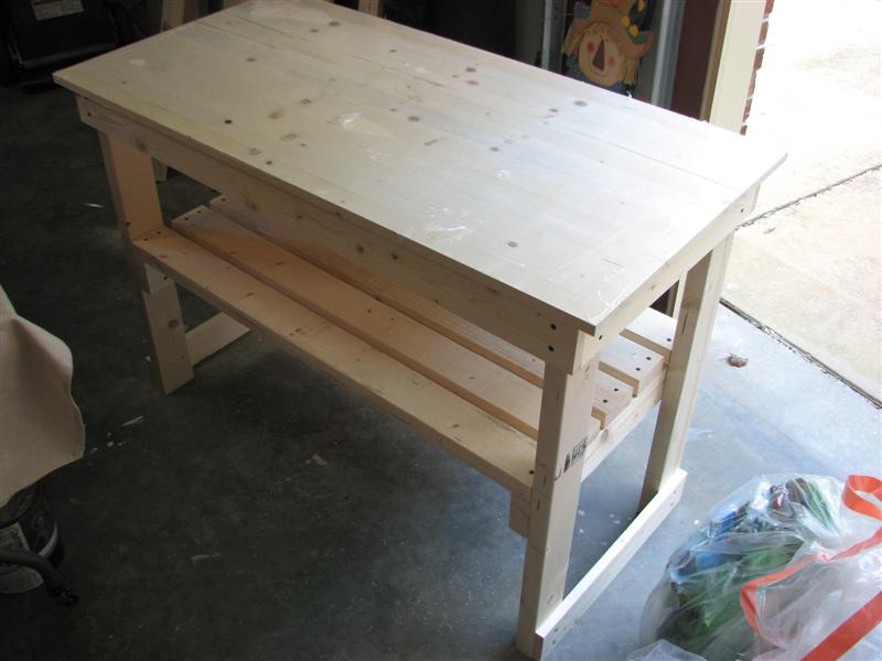

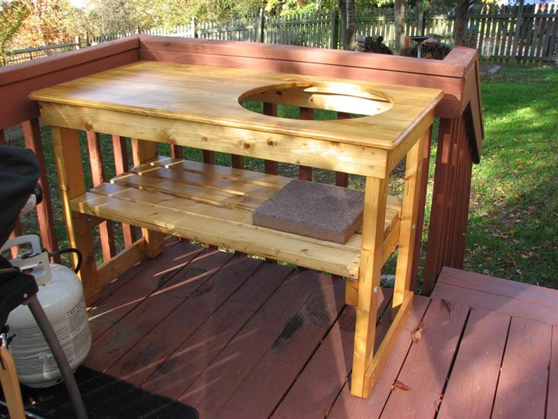

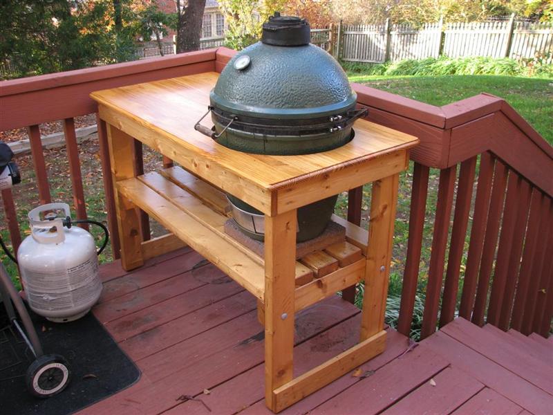

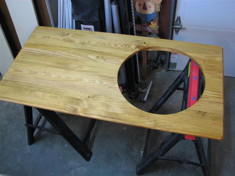

    Nothing exceptional, but needed a table for the Egg. Still deciding on whether and where to put wheels. For now, I have rubber feet located under the legs to allow for water flow. Also want to make a drawer for tools and a holder for propane fire starter burner. The top is a loose fit so that I can have the Egg on either side if I choose to relocate.
    Since I have neither a jointer, nor a planer and I didn't want to get into the expense of cypress or something similar, I went to Lowe's and sifted through a maze No2 2x4's until I found a few reasonable pieces - same for 1x4's.
    Finished with Minwax Pre Stain Wood Conditioner and Putritan Pine stain. Followed by three coats of semi-gloss Helmsman Spar Urethane.

    That is very nice work. Looking at the finished pic I wouldn't think it was 2x4s. When I saw the thread title I thought it was a green table shaped like an egg.

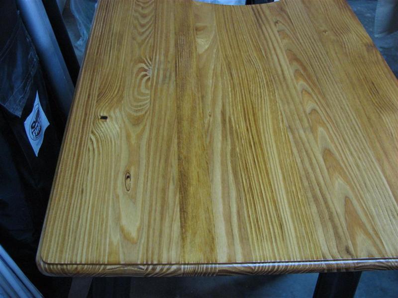

              Gordon, did you do anything extra to glue up the table top? Did you let the wood dry for some time before working with it?

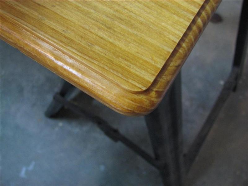

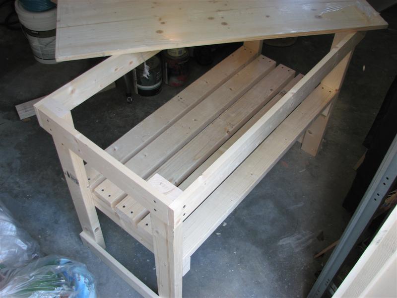

                      Thanks for the compliments everyone. I didn't think of it at the time that I did the original write-up, but now I am reading Richard's question about the top.
                      Since I don't have a jointer and the 1x4 and 1x6 lumber wasn't good enough to make a up a top with say biscuits and glue, I was forced to look (and buy) a pre-built top that is 2'x4'. Found it in the lumber section at Lowe's. I had to scratch through a bunch until I found one that was reasonable. I don't mind knots, but when they fall out and become holes.....
                      Anyhow, I sanded everything down and routed the edge on the top after experimenting on some scrap as to the size and shape that I wanted. Measured and cut the hole with a jigsaw and cleaned up the edge with the router. The stain was one application with a 15 minute dry time before wiping. I tried 5 and 10 as well as two coats and found that this one worked the best for me. Sanded lightly with 180 grit and cleaned off between each coat of Helmsman. Screwed together with 2 1/2" decking screws (the new ones that have the Torx drive/socket). The color blends well with the finish too. No glue is used anywhere so that I can disassemble or replace any parts as needed.
                      By the way, it's not a new Egg - about 15 years young and still going strong. It's the medium size one. I now use this burner to light the charcoal - fired up and cooking in about 10 - 15 minutes: http://www.harborfreight.com/cpi/cta...emnumber=91899 - works great.
