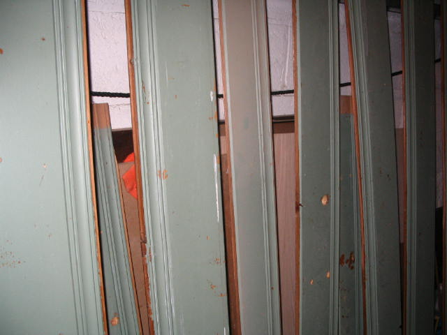

    I made this replica Viking Chest (circa 800 AD) for my Swedish mother. She saw it at a festival last summer....Looks easy enough, I thought. The $400.00 price tag for a box I thought was a little steep. I took a few pictures, did a little research.
    My basement was taking on water after we purchased our house 8 years ago and I ripped out a wall and kept the paneling. Solid pine painted an ugly green with a wide routed detail. This was the perfect project for that 70 year old pine. It had nail holes galore, and seems like a dart board was in the room for a while as well (I made that the top). It seemed fitting not to try to cover up the blemishes and work around the knots, as I left the a half missing knot front and center on the lid.
    The first picture is what the paneling looked like before I did any work to it.
    I then stripped the paint enough to run through the planner to clean it up, but I was having planner troubles if you recall. So I decided to build the chest as is and see what it looked like. I was going for the "really old Viking chest dug out of the ground 1200 years later" look.
    I liked it, but gave her 2 story boards of different finishes with and w/o paint. She liked the w/o paint.
