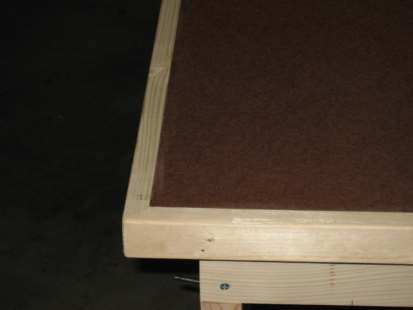

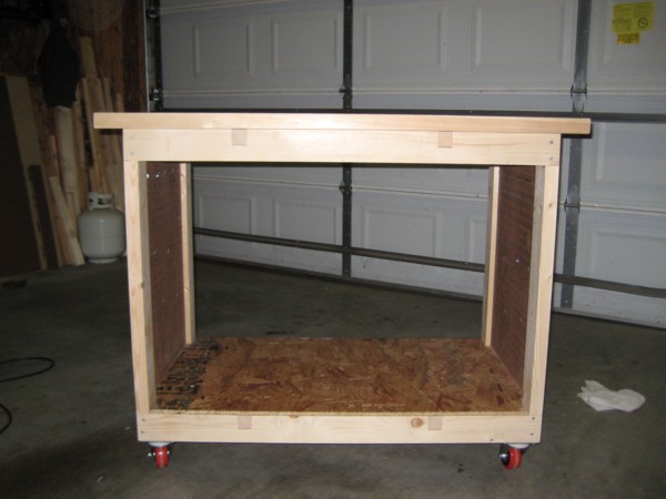

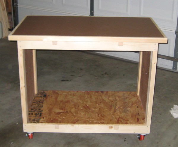

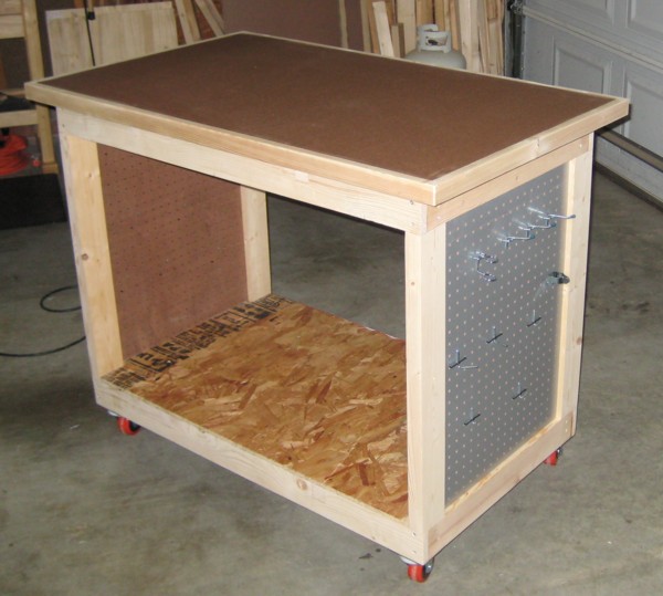

    Just finished this worktable. My wife and I both wanted a work surface that we could walk around and since the garage serves many duties it needed to be mobile. I had some left over Douglas fir 2x4 from previous garage shelves I made. And left over pegboard. The top is a piece of 5/8 particle board cut in half and glued with ¼ Hardboard over the top and 1” thick edging. The bottom Self is some left over wafer board. Not sure but I might add another self but I will how it gets used before I do any modifications. It is on 3” caster for easy rolling.

    Nice talble Luckbox... You will appreciate the mobility if your shop is multi-functioned. Just be sure to lock those casterrs and chalk em it you sit something heavy on there that will torqued in some way working on it. Don't ask how I know!

                  Nice loooking table. Be careful of theose pegboard hooks, and what is hanging on them. They could do some serious damage to a leg.

                        I just discovered I should have planed just a bit better. I measured our counter tops, my work bench, and other table height to try to determine the height I wanted the table. I then adjusted the measurements to include the caster height and the width of the table top and I came to with in 1/8” of my desired easement. I was moving it around this weekend and though this might even make a good table saw out feed table. But I should have thought of that before I made the table. The table is ¼” to height. Still a good work height but I don’t think ¼” would have made any difference and I could have used it as an out feed table.

                          You "could" have used it as an out-feed table. You still "can"............
                          Take off the casters.. take any screws out you have holding the four bottom corners together that would interfere with the cut.. clamp a Pro-Grip 5" up from the cut line (5" on my Porter Cable circular saw from cut-line to where outside of fence meets the edge of the Pro-Grip guide.. may vary with your circular saw).. and fire away on all 4 side taking a hair over 1/4" off the bottom of your table.. re-attach the caster and "rock-n-roll"!
                          Been there.. done that.. and on many occasions.. I call it adjusting on the fly as things change and you have to meet the changes day to day.
                          Or... as an alternative, bring it by my shop and I'll do it for ya. Have you in and out in about 20 minutes.

                            The table is &#188;” to height. Still a good work height but I don’t think &#188;” would have made any difference and I could have used it as an out feed table.
                            Nothing that can't be fixed with a good 1/2" plywood base under the table. It's also a pain, but it's not too late to take it apart and shorten the legs a bit.
