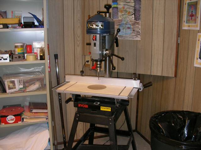

    I probably have one of the few Ryobi WDP1850's (a.k.a. "wood drilling systems") ever sold. You just don't run into many of these. I like mine. It has a constantly variable speed, and the VersaTable and fence are handy.

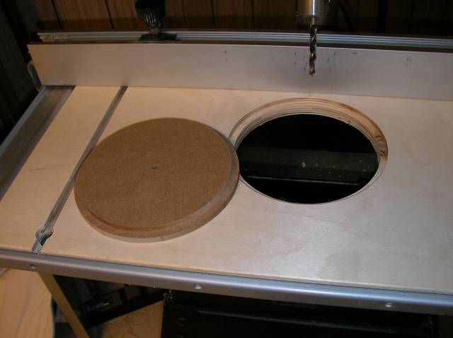

    The original table insert on the VersaTable was a 12" x 22" piece of MDF. It was clearly an afterthought. It just sat in a channel and was inclined to flex a little bit.

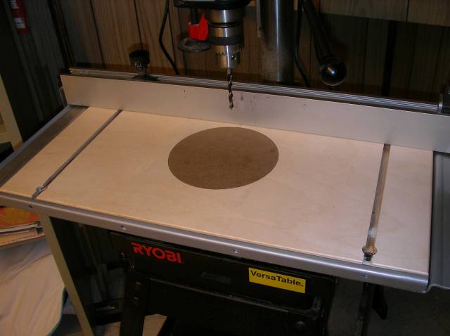

    I finally decided to upgrade to a piece of BB plywood. I included some t-slots for additional fence/hold-down options, a circular MDF insert that I can rotate for fresh backing, and I came up w/ a more secure means to attach it to the VersaTable than gravity (no offense to the big guy upstairs).

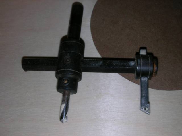

    But the real find was the carbide-tipped lathe bits I purchased for my fly cutter. The fly cutter originally came with a HSS bit which overheats and dulls very easily. I purchased the lathe bits about 1/2 year ago, and never tried them until now.
    Wow, do they cut nicely! Made quick work out of cutting the hole in the BB plywood. And I have 15 carbide cutting edges (should last a lifetime!).
    If you have a fly cutter, you may want to investiate the carbide-tipped lathe tools.

      That's a interesting drill press mate, I'm going to keep an eye out for one. Nce tip about the lathe bits as well. I take it the lathe bits are for a metal lathe?

        Hey, I like that round sacrificial insert ... great idea. For the past few years I've been getting by with a very quick-and-dirty DP table that I cobbled together in about a half-hour; it has a square insert that I can either rotate 90* and/or flip over to give me eight fresh positions for the bit to land. Your round insert provides many more options. I'm going to steal that idea when I build my new DP table, RSN ...

              I'm certainly not the first to think of a round insert. And I had considered using a square one (because they are easier to make additional ones down the road). But then I couldn't have used the fly cutter. :-)
                Yes, I believe the lathe bits are intended for metal. I inspected the one I used to cut that hole more closely this morning and it is as sharp as it was when I started and has not discolored. Had I tried that w/ the HSS bit, it would have needed sharpening after that one hole.

                    That round insert is a great idea. Gonna have to put one on mine. Right now I just use a sacrificial board.
