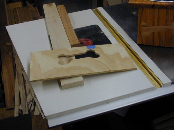

    With the graphic Anna sent I scrollsawed this template:
Name:	bone inlay template.jpg

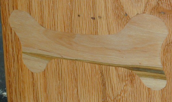

    Milled the inlays from Ambrosia Maple scraps:
Name:	bone inlay1.jpg

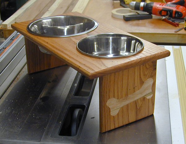

    And the result
    Not a real project, but fun, I hope the daughter and her Bulldog enjoy it.
    It is Red Oak with Maple inlays, finished with nothing but 2 rounds of natural Danish oil. I cut the holes for the bowls with the 1587 jigsaw. The 5 station feeder I did for our mob I routed the holes, jigsawing is definitely the way to go.
    The inlays were done with a Whiteside inlay set and Dewalt 618 router with clear base. The clear base sure makes it easier than a solid base that I've used for inlays before. I think I'm 'touch challenged' so I need to see where the bushing is.
    Thanks for taking the time to look,
    ken
