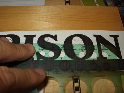

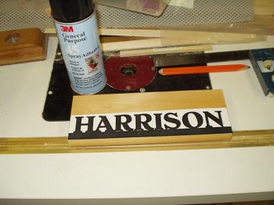

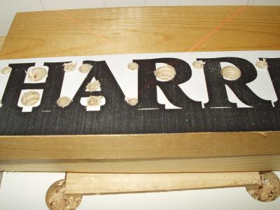

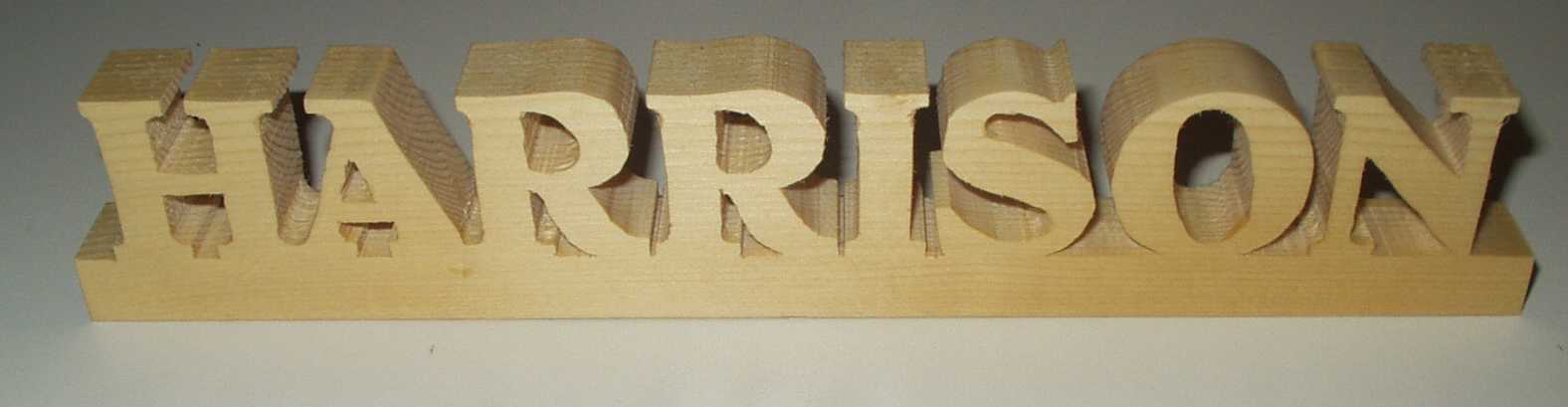

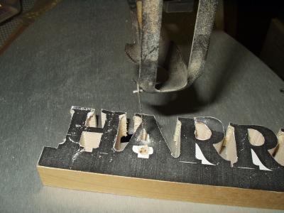

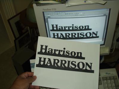

    Here's a quickie project finished in about 5 hours for a baby
    party. Obviously his name is Harrison. The name is long so I
    used smaller letters than usual making the detail a bit
    tighter than normal.
    Step 1 - Compose in Microsoft word, 128 point type, and print it. I draw a solid bar underneath to tie it all together.
    Step 2 - Glue it to the wood
    Step 3 - Mark all the inside tight corners with a circle template,
    label the size holes like the "S" here.
    Step 4 - drill the holes on the DP using brad point bits
    Step 5 - cut out the letters on the scroll saw, cut out the inside cuts, too.
    Step 6 - Peel off the template, belt sand off the rest. clean
    up the edges as best you can using 1" belt sander and needle files.
    Step 7 - finish with a coat or two of tung oil then a clear
    spray varnish several coats with a bit of sanding

          Nice, Loring. What font is that? It really seems to lend itself to this type of scroll work.
          jethro.
          <font size=\"1\">Never attempt to teach a pig to sing; it wastes your time and annoys the pig. -- <i>Heinlein</i>
          http://www.jeffriegner.com</font id=\"size1\">
            • 22109
            Old Century. came with Print Shop
            I like the Swashbuckling "O" and the swagger in the tops and bottoms of the letters (not flat top) like the A, H and R if you look closely.
            let me know if you can't find it.

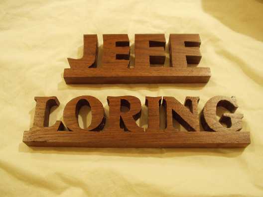

                        Popped out a couple more this week
