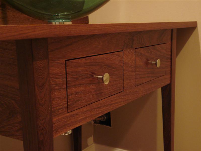

    The Base:
    The aprons have haunched tenons that join into 1.5” mortises on the legs. I made the tenons as long as possible which required them to be mitered.
    The taper on the two inside edges of each leg begins 0.25” from the bottom of the apron.
    The front apron and the drawer fronts were cut from a single board. The gap between the drawer openings was determined by the diameter of the drain pipe.

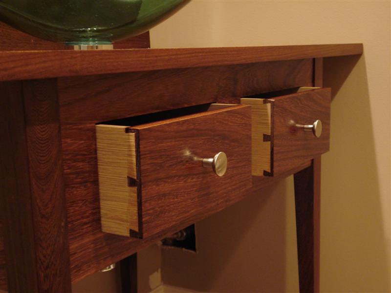

    The Drawers:
    I made the drawers last because they required the most guts: I hand-cut the half-blind dovetails. They’re not perfect, but I’m happy with them . The sides, bottom, and back are made from 0.5” white oak. The back is dadoed into the sides.

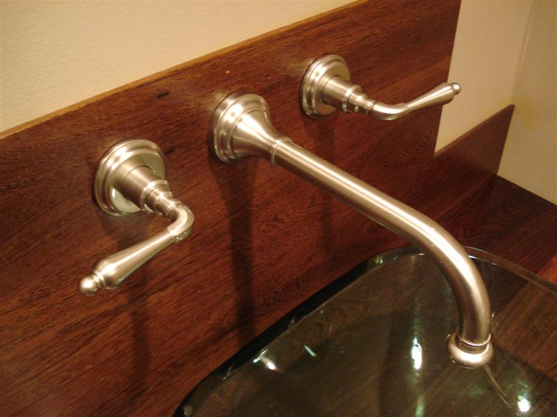

    The Backsplash:
    The backsplash that you see in the pic is not how I originally designed it. The middle portion was only going to be as high as the sink, but Murphy reared his ugly head when the faucet was being installed. The escutcheon on the faucet would not tighten up to the wall, creating a 0.25” gap. The plumber suggested caulking the gap and that was when I very politely asked him to leave and come back after I had figured out and implemented a solution. Well, the solution is what you see in the pic: I removed the already installed backsplash that was constructed according to the original design, resawed it, planed the resawn pieces to 0.25”, and edge-glued them to create an entirely new backsplash. It is quite plain but I’m sure it looks a lot better than caulk. In retrospect, I think the brushed-nickel faucet looks a lot better coming out of the dark panga panga than out of the taupe wall.
