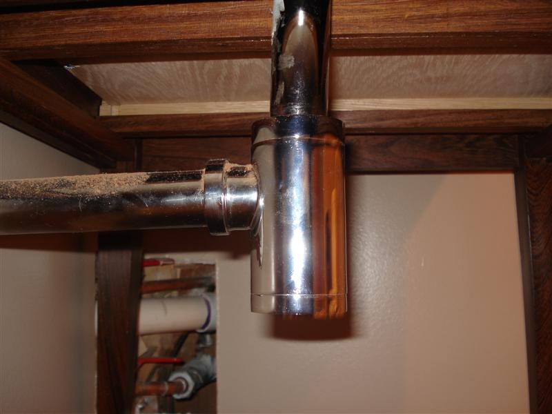

              Great work! Good design, can you post pictures of the drain?
                Here you go (a little sawdusty)...
Name:	Vanity 011 (Medium).jpg
                Chris
