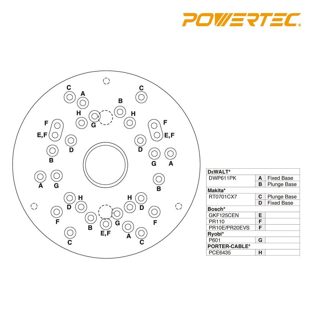

      These may help you, info collected over the years.
      • Dedpedal
        Dedpedal commented
        This may help.

      does she have the universal plate with a lot of holes or the one just for Ryobi routers. If the latter its tempting to get a Ryobi router, but they are a mixed bag... I hear many the plastic has swollen and they don't vertically adjust very easily.
      Switch vs trigger, if its on the router both will be inconvenient to use when mounted in a table.
      If you are using a BT, unplug the saw plug on the side and use the saw switch and outlet to control the router is one solution that gives you a easily accessible safety shut off switch but a bit inconvenient swapping back and forth. Or you can buy a tool switch and outlet you can mount somewhere convenient.
      • Dedpedal
        Dedpedal commented
        Her husband is a metal worker and made her a copy of the plate I have for universal fit. I’m sure we will find her one used here soon.
