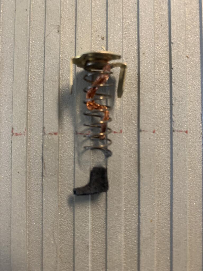

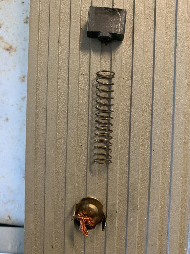

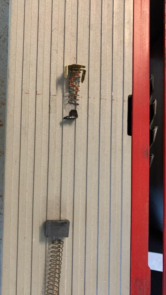

          I think the brushes that were recently replaced were in another saw Click image for larger version

          • Dedpedal
            • Feb 2020
            • 256
            • Palm Coast Florida
            I took the brushes out of an old one I had under the workbench,cleaned them up and now it runs like a champ.
