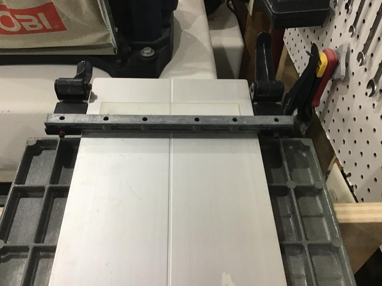

    These are some questions I have while I'm fully restoring my BT3K!
    1. Is this the proper part#15 (guide bar) in the SMT assembly???!
    Sent from my Pixel 3 using Tapatalk
  • Jim Frye
    • 1344
    • Maumee, OH, USA.
    • Ryobi BT3000 & BT3100
    They look like the ones on my early BT3K. I can't get to the SMT from my BT3100 just yet, but I think they were the same. Can you post pics of the entire guides with both sides shown? I'll try to get pics of the ones on my SMT tomorrow late.
    Jim Frye
    The Nut in the Cellar.
    • Jim Frye
      • 1344
      • Maumee, OH, USA.
      Here’s pics of the SMT guide bars on my BT3K & BT 3100. Notice the BT3100 bars are upside down channel shaped while the BT3K bars are solid with rectangular cavities.

      Jim Frye
