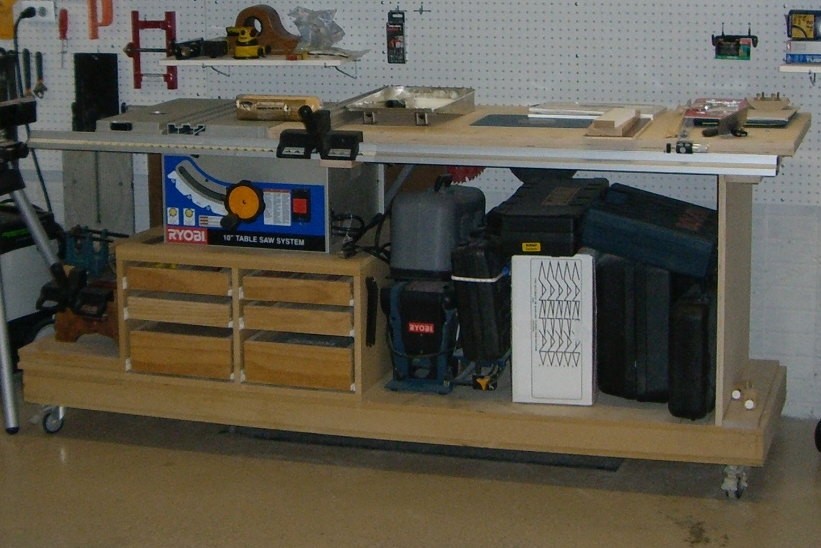

            Here's another question...
            I'm thinking of putting a mobile base (a la Delta knock off from Harbor Freight). With steel square tube instead of hardwood. Any thoughts at that length? About 6 feet all told... And I'd have to put a plate near the left half for the saw table legs to set on...
              • 3122
              When I had my BT3100 it was on a mobile cart as shown below. I have an HTC mobile base now as you describe for my Rigid 4512 with 8' rails and legs on the far end. I 'm planning (someday) to build a new bile cart for the 4512 similar to the one I had on my BT3100. It was just much easier to move the cart than it is to move the new saw on a mobile base.
Name:	BT3100 Mobile.jpg
