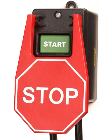

              The other thing I would advise you keep is the switch. IIRC there is a known issue and Ryobi (or somebody) was replacing for free at one time but I dont know the details. I have been through 2 switches and have now replaced it with one of these. Much better and safer.
                [ATTACH=CONFIG]22577[/ATTACH]
                That's been on my list for 10 years now... the placement and size of the stock switch just doesn't seem safe.
                      I need to swap out my stock switch, it's the original top on button and bottom off. The on button is loose, but I installed one of those on the left of the stand for primary on/off duties, and now leave the original switch on. The off just serves as an emergency stop.

                          I actually have a replacement rocker switch with cover. Since I've started making adjustments/improvements to the saw (It was my dad's, I replaced an old craftsman direct drive with the BT and couldn't be happier) I've been reading more and more of the information out there. Changing out the switch is next on my list, I just have to figure out exactly what needs to be done there.
