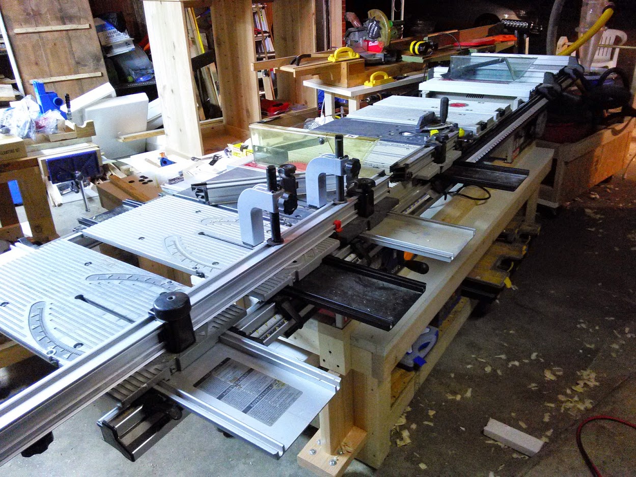

            Progress so far:
            Overall view:

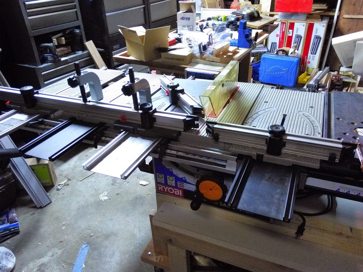

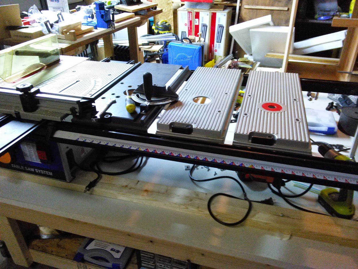

            Cross-cut side -- planning on having the extended miter fence attached across a few aligned saws dedicated to 90 degree cuts aligned using the back holes on the 21829 sliding table (realized when I went to start adjusting it tonight that one of the plastic pieces underneath is broken, so there's another sears parts order). Seems like I may be able to do angle cuts from the front stops without removing the rear fence.

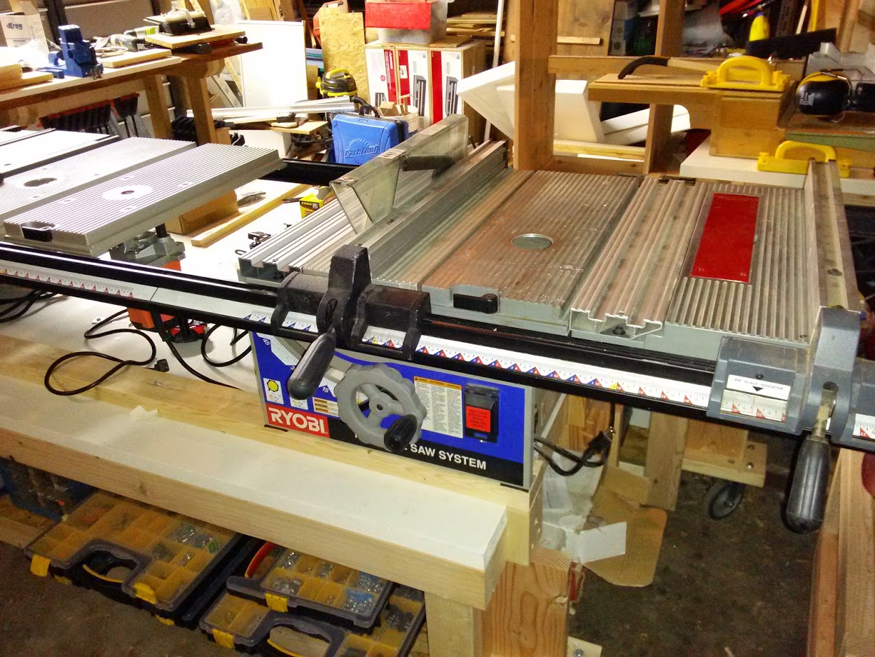

            Router section -- waiting on a replacement cord for a craftsman router to go on the left / harbor freight plunge router on the right. Should give the option of using miter slots or a SMT.

            Rip section -- extra top with a zero clearance plate on the right to fill things in. With a miter slot on the rip saw and the miter slots on the additional top, that should allow for miter based jigs later on if I decide to go that route. Figured since I'd be adjusting the height of the rip saw most often, I'd swap out the adjustment wheel with one from the 21829.

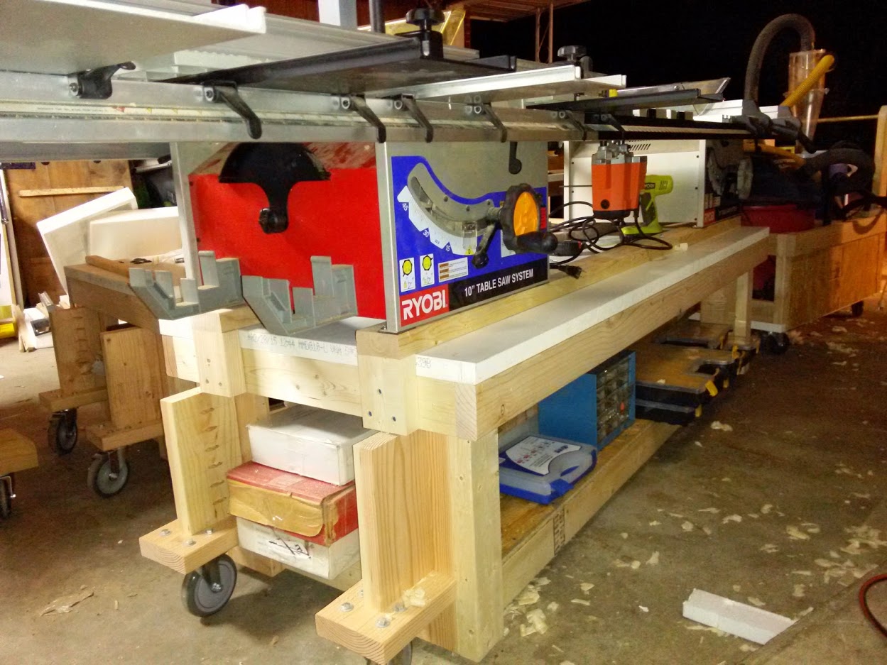

            View from below (note the left side has been replaced by the side of the 21829 to get the updated fence holder bracket):

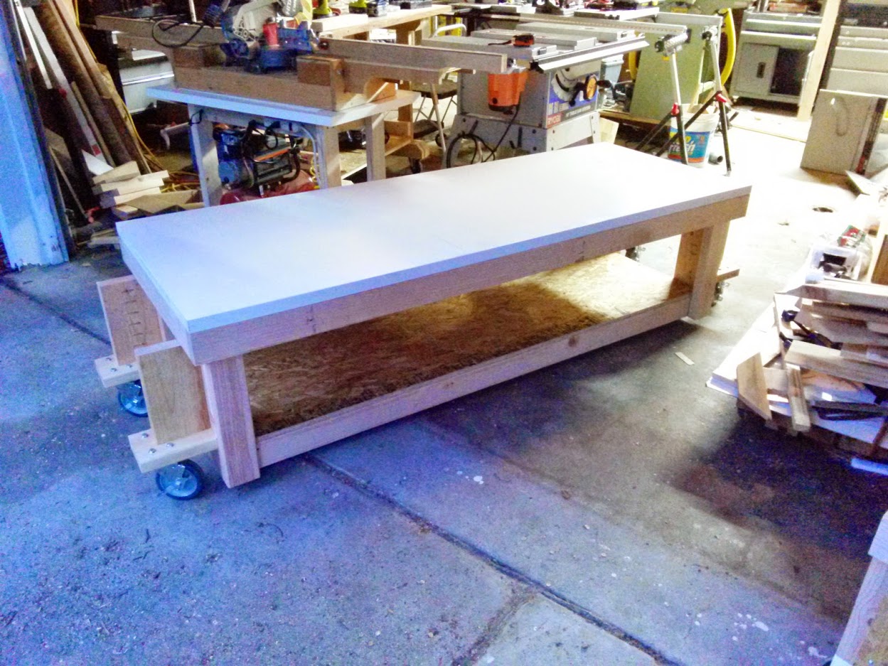

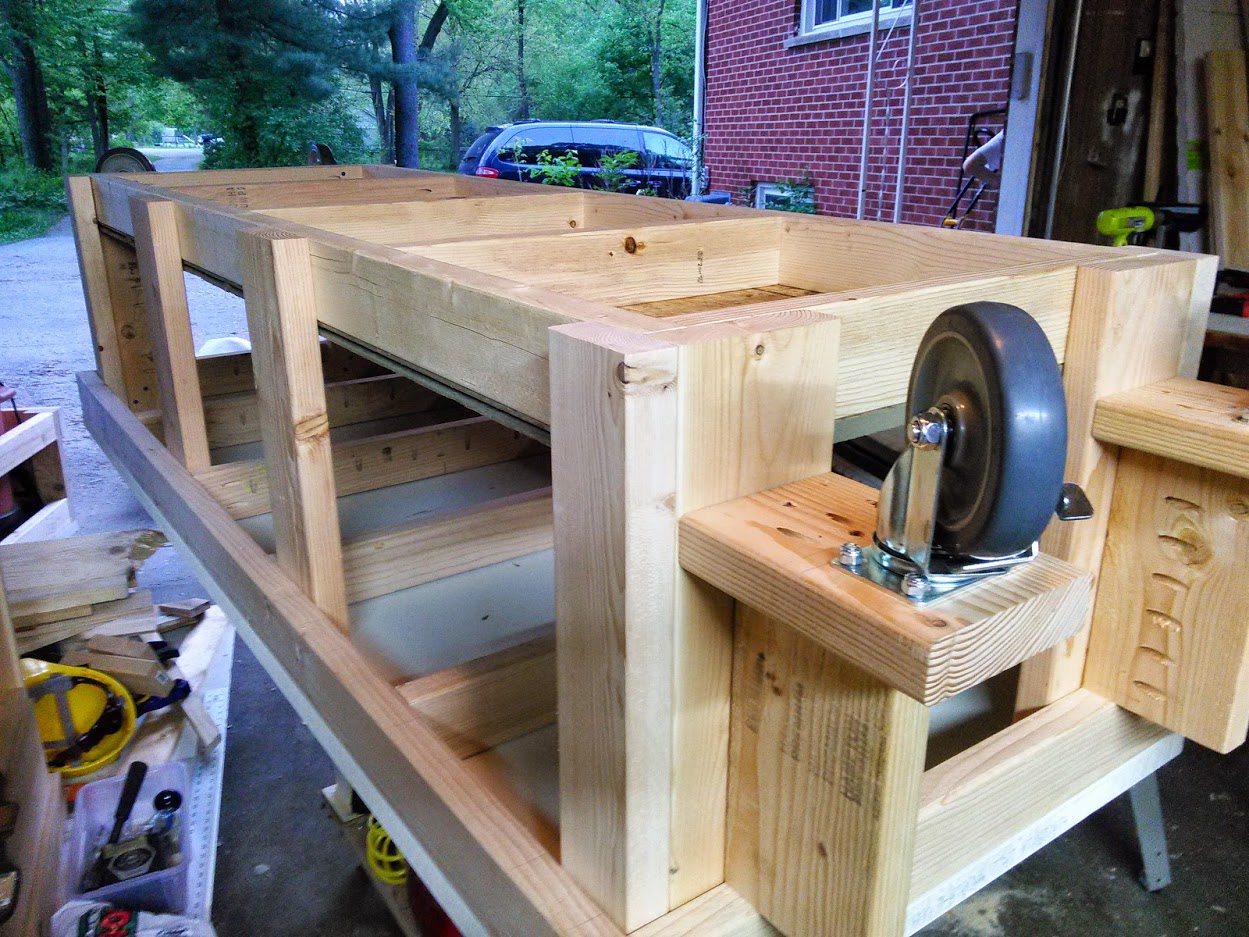

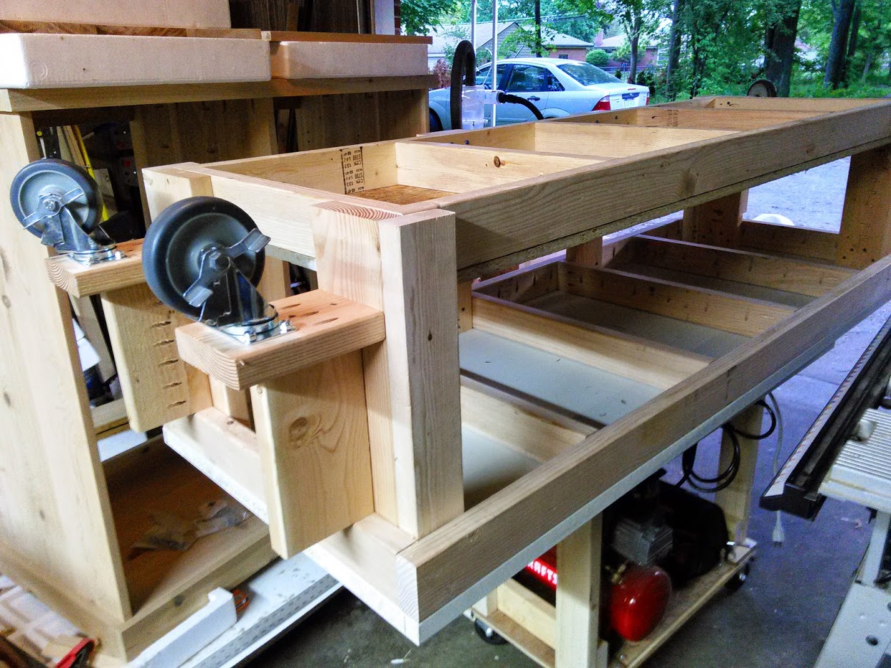

            Views of the cart (this is actually cart #1 that I'm intended on using as an assembly table -- I used it to build an identical cart for the saws. The only real difference between the two is that the saw cart has total locking casters). Top is 2x4's with a 30x80 door on top, bottom is 2x4's with 5/8 T&G OSB on top, most everything fastened together with a Kreg jig.

                  Other points to note: the saws are mounted to 2x4s screwed into the base on each end, so I leave the option open later to remove the saws and use the base as another assembly table.
