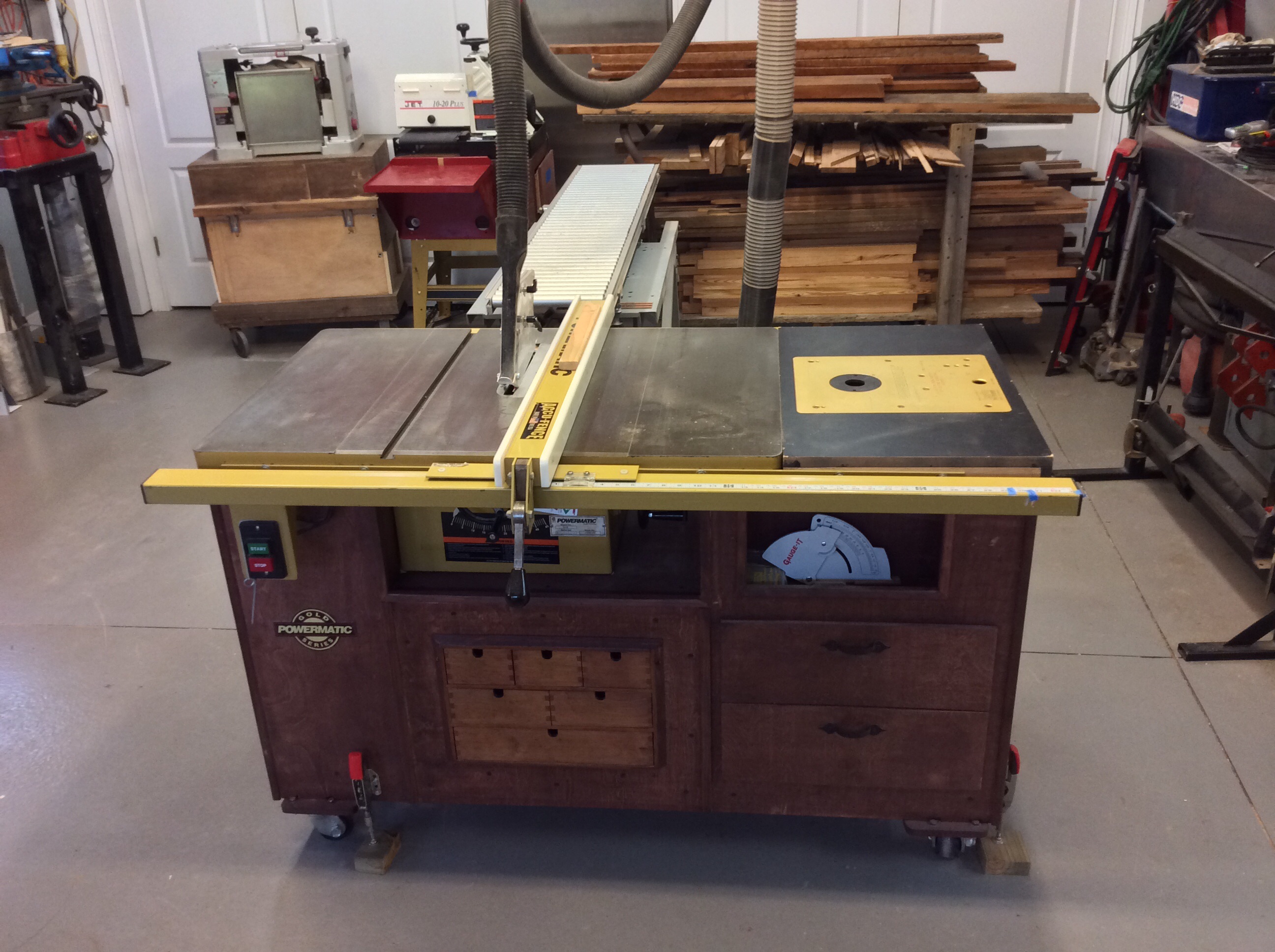

      Ben, here is a pic of mine. It was made back in 2009 and I am pretty happy with it with the only exception being that it should have had a more heavy duty mobile base solution. I had been operating out of my 2 car garage and it needed to be wheeled away from its storage position every time which was a pain. I am in the process of creating a dedicated shop (13x17) so once its in there I hope it wont be moving much at all!
      I created a step by step diary of the build which you can see in this thread.

        What size are your extended rails?

            They are extra half rails so that's a total of about 67" I think and I can cut up to 40 ish right of the blade.

              The big limitation with the SMT is the distance before the blade and I abandoned my SMT a long time back. Once I got the miter slots I built various sleds for cross cutting and panels and they are far easier and more accurate. As you suggested I did keep one to use if necessarily but I think thats only happened once in the last 5 years when I needed to cut some strange angle. As it happens I have a plan for an adjustable angle sled and just waiting for a reason to make it.
