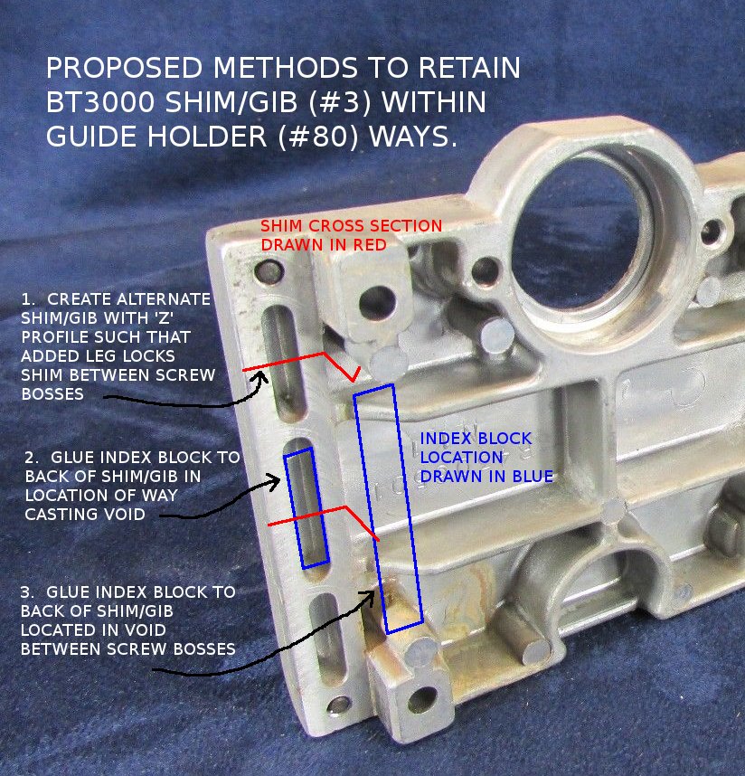

              • mmcmac
                • Nov 2014
                • 53
                Originally posted by I saw that!
                I thought it might be a clip-on solution that Ryobi created after complaints about the falling shim syndrome, since he said the plastic supports he linked to (at bottom of his article) were an alternative if you don't want to drill holes.
                They must be glued or taped in place then.
                I don't know why Ryobi didn't design the shim/gibs as a folded "Z" cross section vs. the existing "L" cross section. Doing so the additional stub leg in the Z would extend into the guide holder casting (#80) between each pair of screw (#89) bosses. That would be a trivial manufacturing step/cost and would lock the shim/gibs more securely than any alternative solution I've seen. A retrofit which takes the same approach is to glue a block on the back of the L shim/gib (#3) which extends into the casting void between the screw (#89) bosses. Similarly a block can be glued onto the back of the adjacent L leg which extends into the guide holder way casting void. The guide holders in my bt3000s all have three long voids in the ways (presumably to control casting shrinkage) into which the shim glued block can key.
                After further consideration I wouldn't recommend gluing the shim/gib directly to the way as the area of adhesive contact needs to exclude the set screw (#73) locations by a considerable margin. And even then taking up on the shim/gibs will cause distortion of the shim as it deflects relative to the now glued centre, affecting the set screw pressure distribution. Gluing a free block to the rear of either shim/gib leg allows the shim to float while creating a positive key against the casting. Removal of the block-keyed shim would be trivial compared with trying to wrestle out a shim intact which is adhered to the way.
                Edit: added jpeg markup illustrating above. Base picture kindly donated by Ebay.
                Last edited by mmcmac; 12-04-2014, 07:40 PM. Reason: Added jpeg illustrating three approaches to index shim/gib in its way.
                • mmcmac
                  • Nov 2014
                  • 53
                  #23
                  Or simpler, just cut one half of the flat shim stock longer, then form that half with a leg to wrap around the top of the guide holder and one to wrap around the bottom -- basically, just much longer lips than the originals have.
                  Empirically the folded tab retainer isn't very effective unless the shim/gim is kept lubricated and its path free from debris. To varying degrees I've found this failure in all 3 of my bt3000s although that may not be a representative sampling.
                  So I don't see how increasing the tab length alone will remedy the situation unless the extended tab was used to eliminate further bending stress. eg: each tab could be punched for a retainer screw passing into the guide holder. The problem is the shims are fabricated from tempered (brittle) SS and the tight bend of the tab fatigues the SS leaving the result prone to failure with any further bending stress in usage. IME once a tab is flattened due to seizing against the locker bracket, attempting to rebend the tab is futile as if it doesn't break off outright it is so traumatically weakened that it offers little to no resistance against the shim riding out of the way. That was the motivation for my prior suggestions, specifically to move the retaining stress from the fatigued manufacturing bend.
                  Grabber tabs cast as part of the guide holder top and bottom would retain the shims via holes in the shims as they're snapped into place.
                  That does seem like it would buy some insurance but I'd be concerned over the tab bend flexing when attempting to retain a seizing shim/gib -- presumably the snap in nature would allow for some play when seated.
                  Although one thought I had was indeed to lengthen the tabs not for the purpose of retain the shim/gib but rather bent into an approximate round pocket such that it could retain a wad of lubricated saturated felt packing. Doing so would act to clear the locker bracket of sawdust accumulation while maintaining a lubrication film on the surface. This could be done for both tabs at a given shim/gib end and to each end of the (#86) way shim as well.
                  At any rate, as there's evidently no official shim fix supplied by Ryobi -- other than upgrading to the BT3100...
                  From what I understand of the spring loaded bt3100 redesign, I'd likely choose the bt3000 adjustable hard gibbed approach. While it certainly has its warts, under proper conditions (which can be virtually guaranteed as above) stress wear on the way and shim/gibs occurs only under usage load vs. during all elevation changes of the guide holder due to the constant spring tension. A spring loaded gib is subject to deflection under load as well although I'm uncertain to what degree this occurs in actual usage.
