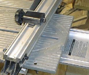

      I have heard the mod described to put the holes at the front end of the SMT for the miter fence. That allows moving the moter fence to allow four more inches of crosscut (but with no bevel capacity in that position. And It appeared in a later BT3 clone, I think the 21829.

            Here are a couple pictures I found of when I modified my SMT on the 3100 back in 02.
            I wasn't aware that they had such a kit either. Wow. Just goes to show you, no matter how much you think you might know, you may not know it all.
            Opps. BT3000 I mean.
            I did make that modification to the BT3100 as well, but later. The pictures are the 3000.

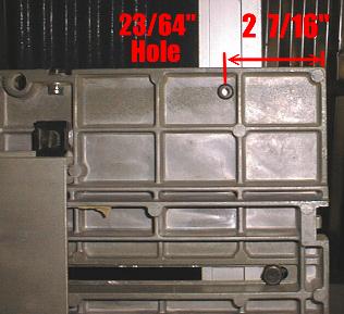

                        I took a look at my SMT - from an early 13 amp BT3000 saw - and the holes seemed to match the "new" holes in the template. And my SMT had the half-inch cutout in the end that looked factory-cast. The corners were rounded like most other corners on the underside of the SMT.. I'm the original owner... nobody modded this saw before I got it.
                        My spare BT3 SMT had holes matching the "new" template holes as well though the cutout is about an inch wide and looks like it was filed by somebody - the edges are sharp corners and there is no paint coloring over the newly exposed metal. This came from a used 15 amp saw I bought many years ago so I don't know its history. Was this SMT modded at the factory with a 1" file? Or filed by the previous owner? I don't remember filing it though I might have eons ago to make it slide as far as my original SMT.
                        It seems the mods in the kit were implemented fairly early in the BT3000 production run since two different 13 amp saws (mine and "I saw that"'s saws) seem to have the mods from the factory. I didn't think to check the production dates or serial numbers of my two saws.
