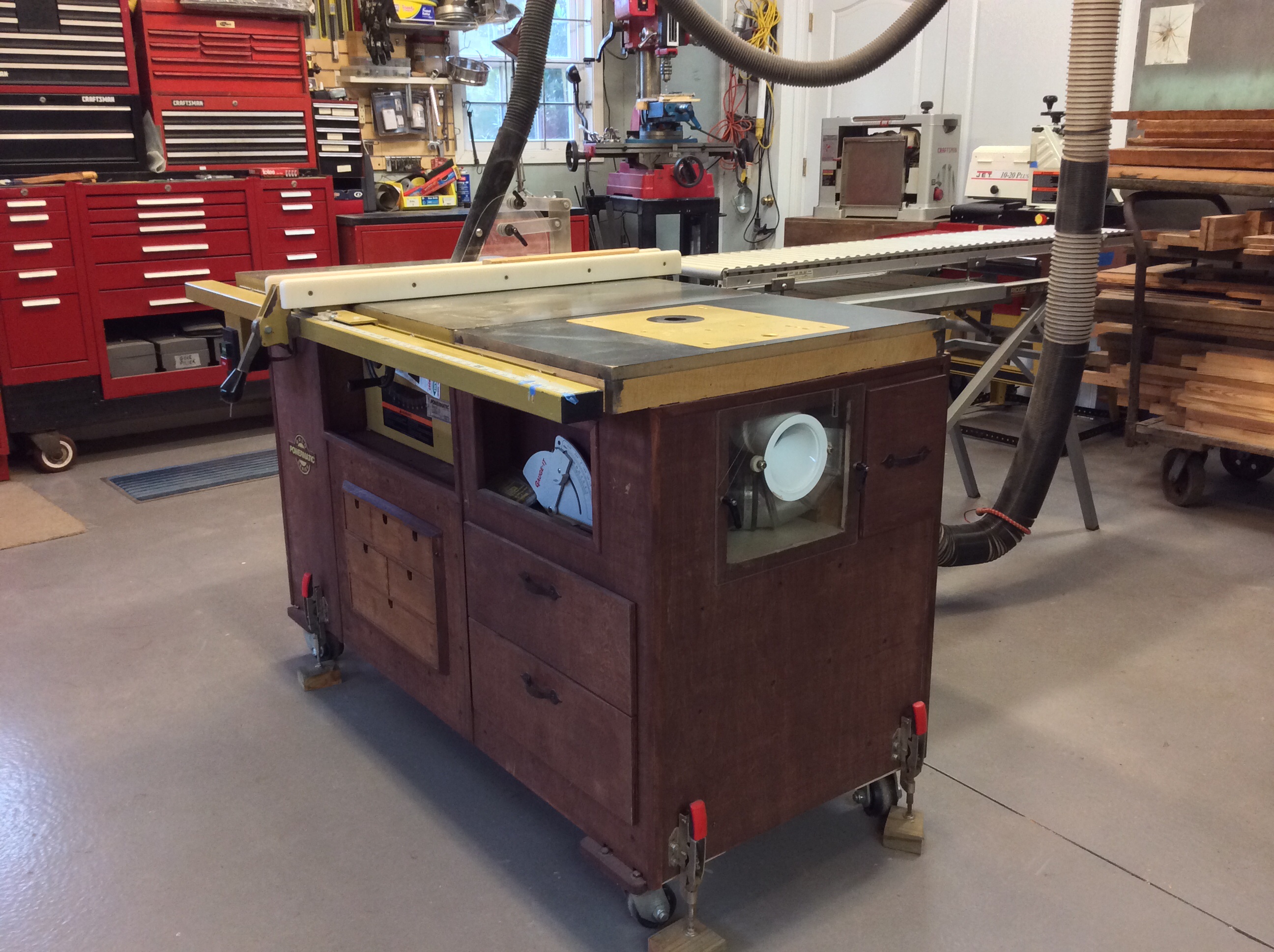

    Photos of levelers on my saw cabinet. Note small diameter very heavy duty swivel casters. This saw does not have to be moved out of the shop and is on a level floor or it would have 5" casters.
    The torsion box was constructed, saw cabinet was built to provide the desired height and then the other cabinets were added.
    Don't forget dust control. You may want to use it indoors later.

      capncarl that's a nice powermatic saw setup you have there as well as a nice shop. Thanks or sharing that photo. I love buying things online but I hate that they are sometimes poorly presented and you have to fine the product somewhere to actually touch it and see how well its made etc. The big box stores don't appear to have any of those levelers so I guess I will get them from amazon or craft some myself.
      Since you stressed the use of a torsion box I have noticed some pictures of some carts online that appear to have quite some sag in them. Thanks for that pointer again.

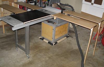

      Here is an image of an out feed and in feed setup I am thinking of using Click image for larger version
      I think those images came from this site somewhere but dont remember what thread.

            I believe my De Staco levelers came from Woodcraft in the Atl. area. These are the auto adjust type, not sure what it adjusts but it has several things to fiddle with. I wouldn't recommend this type, save $5'each and get the non adjust type. I bought them because the others were out of stock, should have ordered them.
            I wanted an out feed table that stays attached to the back of the saw and hinges down out of the way for storage. Not sure I like little legs that I know will get tangled up with my size 13s. I liberated a Rigid miter saw utility vehicle cart when my miter saw was installed on a perminate stand and am using it with a 6' long piece of roller conveyor attached to the top. The roller conveyor height is easily adjustable and easily fits behind the table saw, thickness planer, drum sander and jointer. The downside to this type out feed is its width, wide pieces need additional supports.
