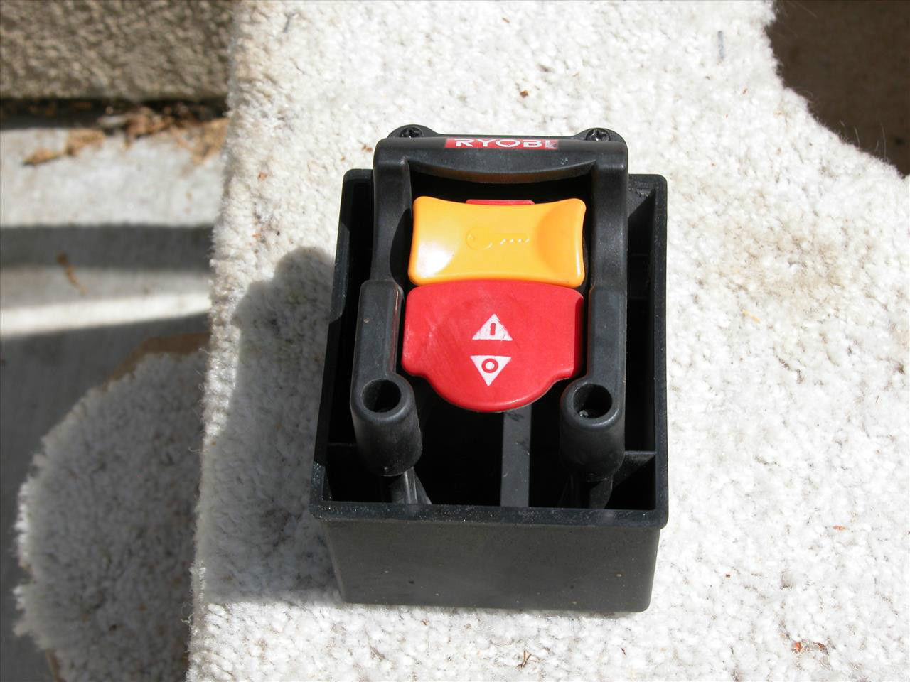

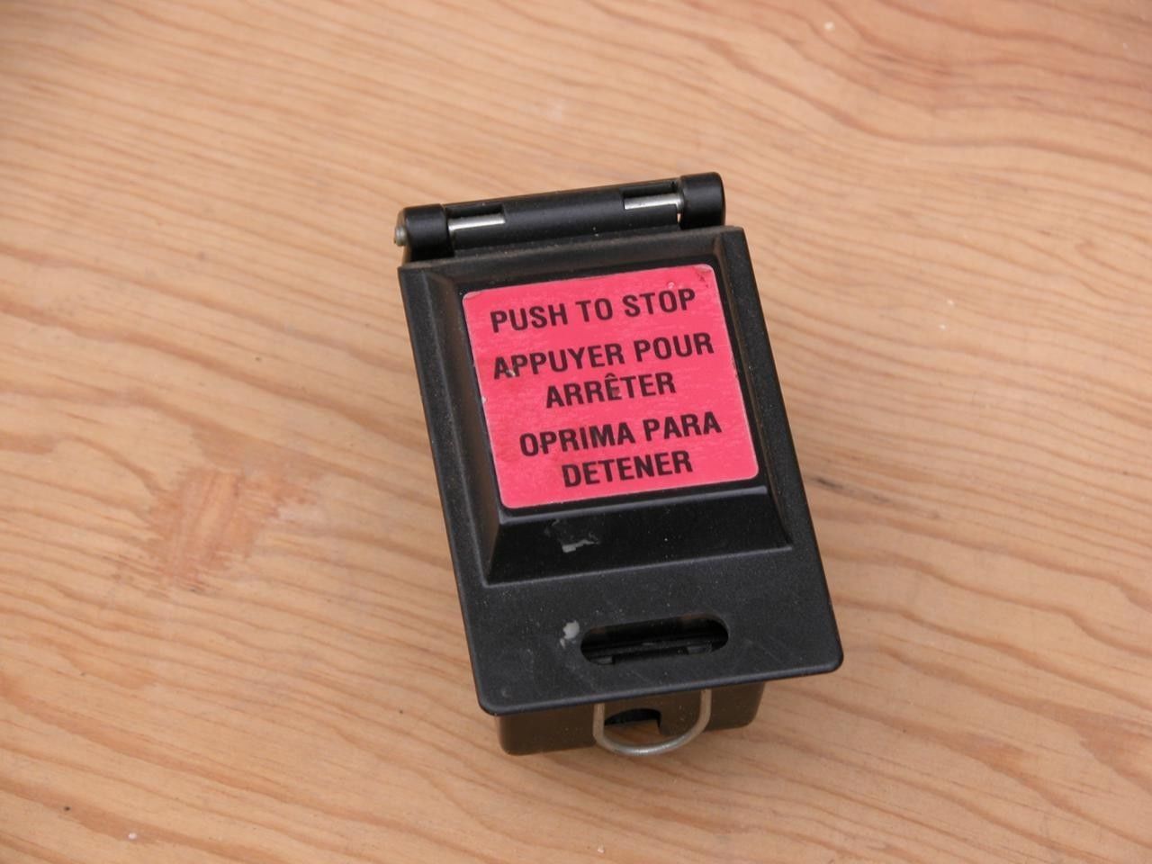

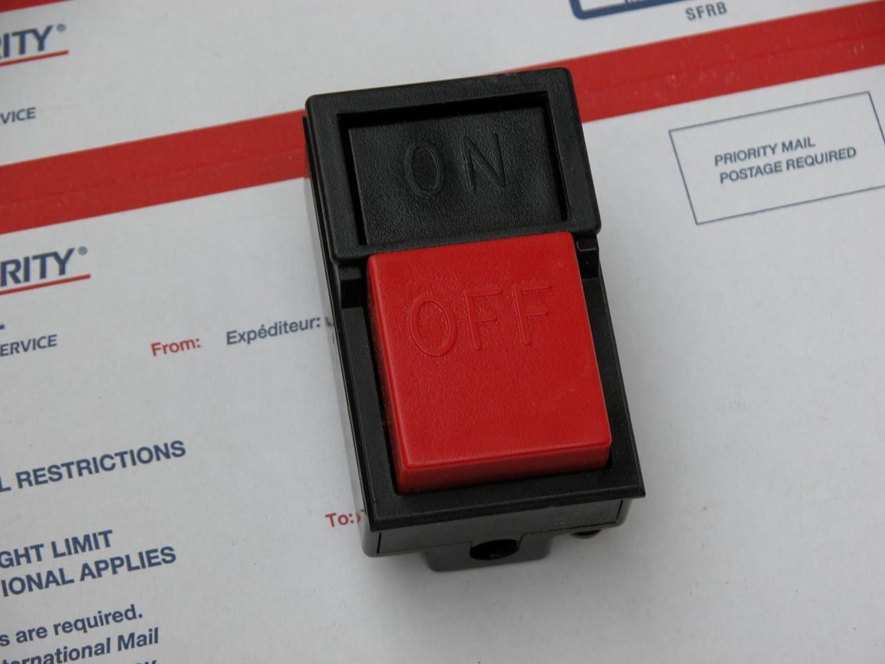

            there's two switch recalls,
            one for early BT3000s, where it was not easy to turn off.
            THis was for switches with two buttons on and off.
            Replacement was a switch that had a rocker switch and a safety cover that you pressed on it and it would turn the switch off, plus a lockout loop. It was very clear when you had the bad switch.
            one for later BT3100s where the switch stick on.
            The replacement switch on later production was made better but looked identical, that's what they want the date of manufacture.
            below are pics: old BT3000 switch, new BT3000 switch, BT3100 switch
            if you think you have the old one, call wayne hill at the number someone posted above and tell him you think you have a recalled switch.

              Hi, new guy Roy from Round Rock, TX here. Not to hijack the OP's thread here, but just wanted to confirm the switches. The one I have is the one pictured on the first row, second column, that's the new BT3000 switch correct? I just purchased the BT3000 and if I recall the date code has a 97 followed by two other numbers, like 14 i.e. 9714 (can't be for sure until I confirm this evening after work). So this must mean the previous owner may have put the newer switch in since I thought the faulty switches were on 2004/2005 models.
              Thanks,
              Roy
                • 22061
                Thanks,
                Roy
                BT3000s were made from 1992 to about 2002.
                if your BT3000 has a 9714 date code it would have been made 1n 1997 and with the 2nd switch (the one with the writing that says push to stop) as the 2-button switch was only made from 1992-1993 and recalled.
                BT3100s had a separate switch issue much later, I think that is what you are confused about.
                  Yes Roy you are correct that is the updated BT3K switch.
