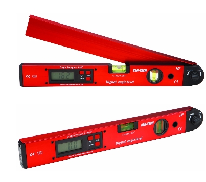

                    Anyone have experience with this from our favorite tool store?
                    http://www.harborfreight.com/16-inch...vel-65451.html
