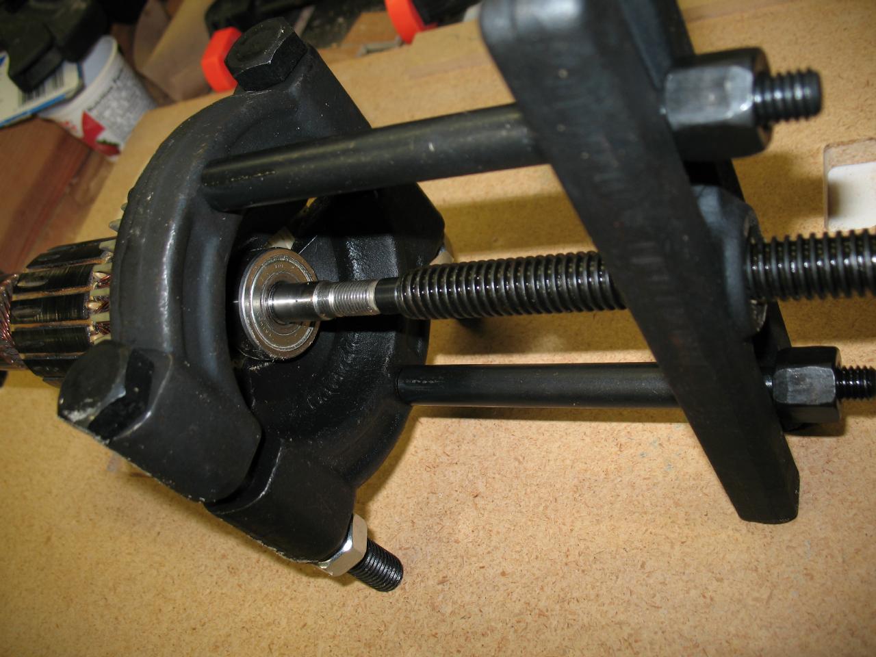

        I do have a bearing puller. I used it to remove all the other bearings.
        Thanks to "I saw that!" I removed the belt pulley easily enough, knowing now that it is reverse thread and pulled the bearing out with no trouble at all.

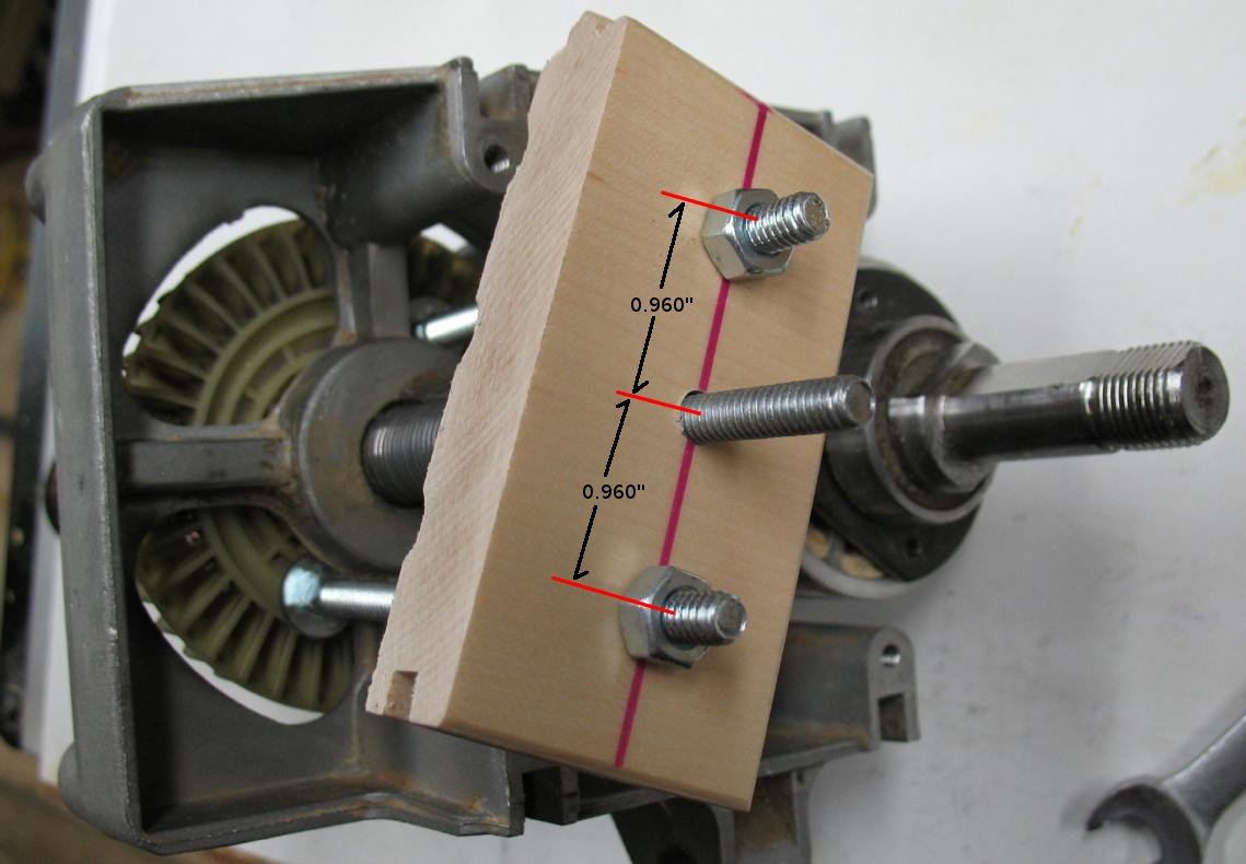

          I replaced all bearings in a bt3000 yesterday on both arbor and armature and as above was trying to puzzle out how to seat both assemblies in the motor bracket (#9) without axial loading of the bearings. I eventually resorted to heating the bearing mount seats with a heat gun on low power. It doesn't take much to expand the cylindrical seats such that the bearings just drop in, including the bearing pair at the rear of the arbor. I'd recommend cleaning out the casting seats to insure you're not fighting any debris as you don't have much time to work before the casting cools. Also seat the arbor before the motor armature such that you don't need to shield the plastic fan when heating the arbor seat. If the arbor alone has been removed for a bearing replacement, shielding the motor housing with a fully saturated wet rag when heating the arbor bearing seat should be sufficient.

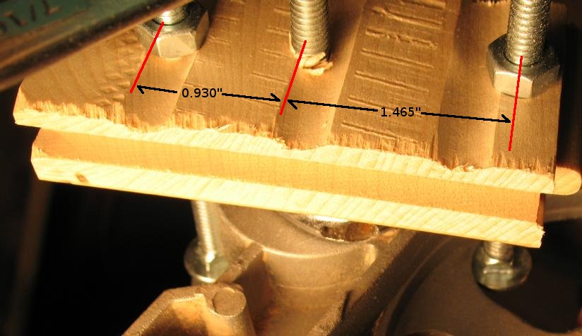

            Also at time of disassembly I didn't have a puller with sufficiently small fingers to grab the casting immediately at the bearing seats when pulling the arbor and armature out of the motor bracket. Pressing against the motor bracket housing periphery itself risks distortion of the casting particularly in the case of the motor bearing. I used a few 1/4" carriage bolts I had lying around and made press yokes from scraps of maple flooring. The head profile of the carriage bolts worked well given the limited clearance to grab the casting seat lips while a center bolt pushed against the shaft. The carriage bolts used here gave a relatively snug fit in 1/4" holes drilled in 3/4" maple. As such the bolt center-to-center distances called out resulted in an assembly tight enough to keep the carriage bolt heads from slipping off the bearing seat lips while under tension. Otherwise a tie wire can be wrapped around the bolt pair, drawing them together. Rotating the assembly such that the bolt heads extend under connecting casting web members is recommended.
            Also in retrospect I'll withdraw the suggestion to use a wooden block and hammer to free the guide holder from the motor assembly. After closer inspection of the locker bracket upper casting I'm quite concerned that portion of the casting could be distorted with too strong a blow. Using a wooden block press yoke and carriage bolts on the guide holder itself (similar to as described here) would be a far safer approach.

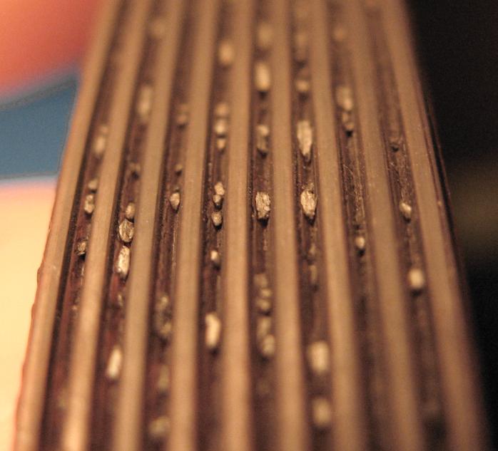

                            There is the possibility this saw is an outlying data point w/r/t resulting pulley wear. I've only removed the belts on this saw for close inspection, but found what appears to be uniformly coloured hard black chips lodged between the belt V grooves. I first thought it perhaps started as wood chips which were then friction charred during blade stall. But I'd expect blade stall to result in motor pulley slip which would likely need to be quite repetitive to create such uniformity. No idea as I'd turned this belt inside out and cleared the grooves with a nylon toothbrush. Fortunately the belt is in far better condition than I'd expected. When I get around to its sibling, I'll take a closer look at the recovered debris.

                              Soak the pulley down in AWSOME for 15 min and all that stuff will come out with a sharpened stick. No sense risking cutting the pulley grooves.
