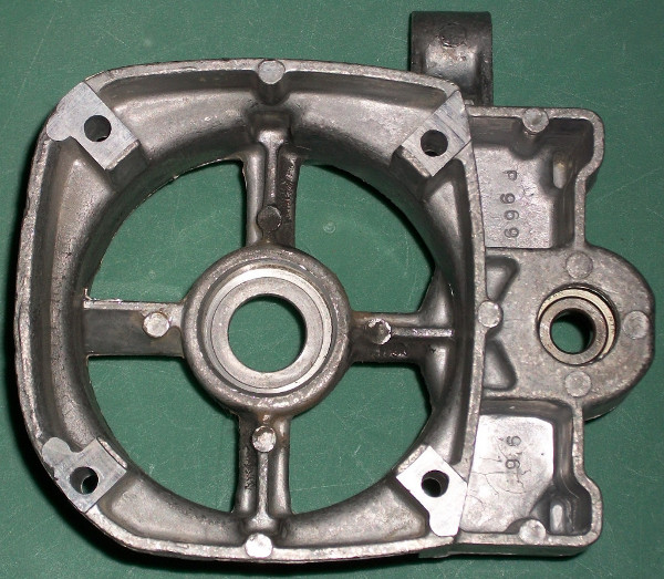

    Edit: Thanks for the email contacts, everyone. The part I am seeking is the bracket or plate that attaches the motor to the saw and raises and lowers the blade. The hole for the threaded rod that raises and lowers the blade is stripped on mine, and repair attempts have not been successful. There are apparently several variants on this part and the one Ryobi now sells under the "correct" part number is not the right part for this saw.
    Is there a way to tell by looking at spare parts we may have whether the ones in our stocks would be the RIGHT one? Like is there a part # stamped on it or anything?

    I'll take a picture this weekend and upload it. It appears that Ryobi made at least a couple of variations of the part but used the same part number.

        Woodturner, have you considered repair by putting a threaded insert in it?
        Yes, after our earlier discussion, I put a threaded insert in it. Over time, however, the threaded insert worked loose. It appeared that the walls of the aluminum "boss" or "tube" were too thin to hold the larger diameter threads required for the threaded insert.
        I tried the helicoil type and the full threaded insert like a timesert, but neither lasted very long. I bought this saw used, and it's possible the previous owner's repair attempts damaged or weakened the casting.

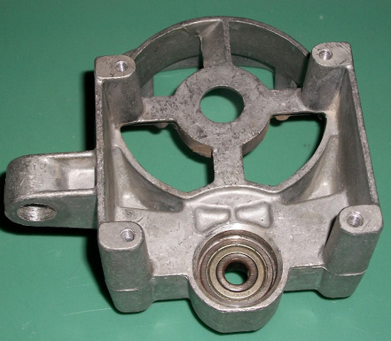

              Pictures of the motor end cap
              The attached pictures show the end cap I need. The only numbers on the casting itself are shown in the first picture - "P 969" in the upper recess and "9 6" in the lower recess. The stripped "boss" is in the top of picture 1, in a side view.

                Trying again to attach pictures
                The attached pictures show the end cap I need. The only numbers on the casting itself are shown in the picture on the right below - "P 969" in the upper recess and "9 6" in the lower recess. The stripped "boss" is on left in the left picture and you can sort of see the stripped threads. The boss is on the top in the right picture, in a side view.
