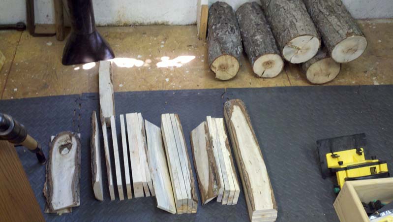

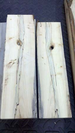

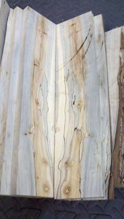

    I've got some Silver Maple Trees that really took a toll from the heatwave last summer. They are over half dead. I saved a few straight branch sections when I was trimming on them last month and finally got around to milling some Sunday.
    I sure wish I had a decent bandsaw. The Delta 9" POS I have could barely rip anything. I ripped everything on the tablesaw. I started with a handsaw, but it didn't take all that long for it to be deemed a stupid idea.
    Some of them has some nice spalting. Should end up with some nice box material.

      They sure look nice, even at this early point. But you raise a question, for me; can you really use "branch" sections?
      I can't remember where it was, but I know that I've read that you can't (or maybe that was "shouldn't") use branch wood as there are too many stresses in it, and thus may end up with all kinds of twist, warp, etc.
      I live up here in NY's southern tier where maple and birch are quite common place, especially in the hills that I used to roam when I was a kid. I've often wondered if instead avoiding these woods today, because of thier expense, if it might be worth my time just to do some more exploring of the wooded areas that I used to roam, as there's lots of deadfall.

        How did you get the first straight side cut? Build a jig?? I've dinked around with some wild cherry logs from our yard--but didn't get a straight enough first line to really work with. Have done some thinking on jigs, but haven't searched for any plans. Got to be a way to use 2x6 or 2x8 and threaded rod to get a 30 to 36" log flat. Carter's jig looks sweet--but scrap is better on the budget!!

          The spalting was the first thing that caught my eye. Should make some beautiful boxes. I was given a couple of pens turned from spalted Hackberry. Makes for some nice patterns in the turnings.

            did you seal the ends while it dried after being cut into logs but before milling?
            If you didn't, you risk the ends splitting after milling
              Looks good for some bookmatching.
                Branch wood can warp more but I've bought it from commercial dealers before. It is common for walnut because the trunk gets sold for veneer. At least I assume it was branch wood becaue of the width of the pieces and the short distance from the pith to the sapwood. Seems like something to watch out for but not a reason to not try. Trees that lean are also known for wood more prone to warping. So regardless of branch or trunk, you can get wood that doesn't want to stay straight.
                I've used my chainsaw before to get a roughly straight side and to split a log down the center so I could rip it on the table saw. It wastes wood but can work. I have some oak from a tree that died and I had to cut down sitting in the shop. It is probably dry now, it has been gathering dust for a few years.
                  Once I got some of the limbs off the tree and saw some black lines through the cross section I had to try to save some. I didn't seal the ends of the log sections. There was a little checking on a few, but the wood was pretty dry. Most of the stuff I cut off has been dead since last summer. Most of the material I'm working with ranges from 5" diameter to 8" diameter. All the smaller stuff is getting used to fire the grill on the back porch.
                  I was kind of leery using the limb sections. Hopefully I won't end up with a bunch of boomerang shaped boards. I've kept them fairly short 16" to 26". This was to produce the greatest yield out of the logs.
                  I used a drawknife to roughly flatten the straightest side, then I'd take a few passes with an old Stanley Bailey No 6 with a cambered blade. I'd take off enough bark and sapwood to give a big and flat enough surface to run on my 6" jointer. If the log was small enough I'd turn it 90 degrees and make a few more passes on the jointer to give me a starting point for a square face. I might have to take it back to the bench and rough the other side with the drawknife and plane, then back to the jointer.
                  Once I had two square faces I started on the other faces on the table saw. If the blade wasn't tall enough I'd finish the cut with a handsaw and smooth it with the plane. I started with the smaller limb sections, but once I started on the bigger ones I ended up establishing the reference surfaces by hand, flattening one side then turning it 90 in my bench vice. I also started using my thickness planer to give a parallel face so I could flip the thicker sections on the table saw.
                  I really, really want a bandsaw with a riser block and a decent HP motor. I don't know where I'd put it, but I do want one. I'm still contemplating on how I am going to mill the 34" diameter trunk sections once they finally come down.
