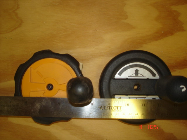

            Here are some pictures of the hand wheels. The one with yellow is the OEM, the grey and black is the one I just bought.
              It's not like my 21829 handcrank. The outer edges of my 21829 crank are like the OEM one you have shown, but with grey plastic spokes and no yellow. I'm guessing it's a BT3000, or maybe the earlier craftsman version.

                That is a 3000 type. It is a nice handwheel.

                    Thanks all! I certainly like this wheel much better than the old one. It has a nice solid feel and positive engagement while the old one always felt like the hand wheel on my long lost BTS-10 that broke about the third time I used it.
                      • 9509
                      Dal3000's replacement wheel is from a BT3000, sadly not the metal one, but still a decent enough handwheel.
                      Jnesmith's if I remember right is from the 22811. Not sure how available those are, but I personally like the look of that one the best... Might be worth filling the non functional voids in the back with epoxy to stiffen it up...
