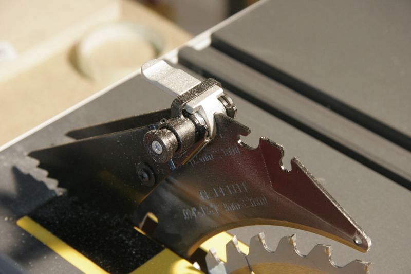

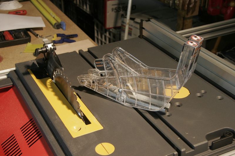

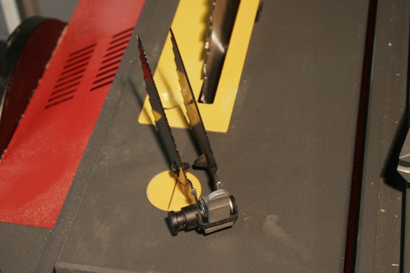

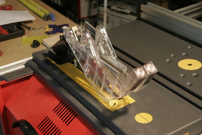

    A few comments about this new saw: All of Ryobi's blade guards have been redesigned, which includes the 22811. The riving knife is now easily removed with a flip of the lever, the blade guard is now a two-piece, and the kickback paws are also removable via a push button clasp. The mobile base on the craftsman is a marvel of engineering design, and it is so well-balanced I think a child could open and close this saw.

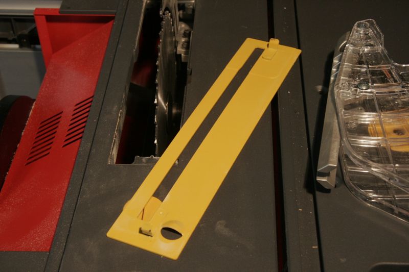

    I think it took me about 2 hours to set up the SMT, and fence. I purchased a zero clearance insert from Lee Styron (leeway workshop), and then some T-nuts from Robert. Great folks to work with, and appreciate the enthusiasm both these guys have for these saws.

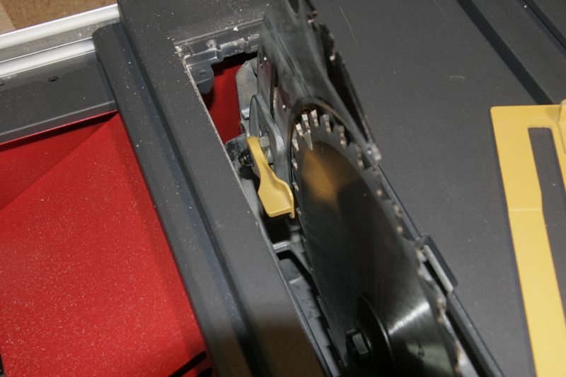

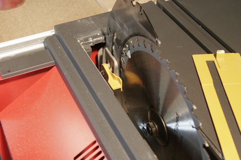

    P.S. here's a few shots of the new blade guard and riving knife:

          That saw looks enticing, congrats! Thanks for the review and the pics.

            New Riving knife looks good.

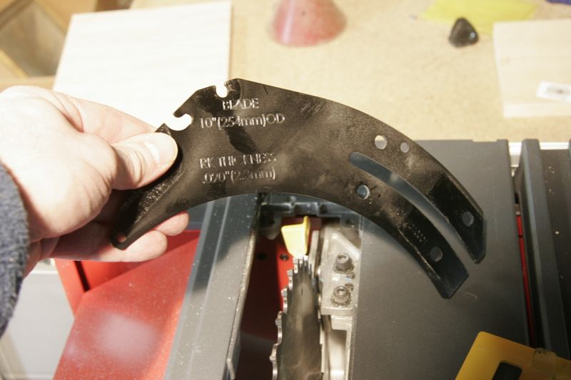

            I notice the knife is stamped RK ThIckness 0.090". which allows use with both thin and standard kerf blades.
            Are you sure its not a 21829 (pic below), the current clone, with a new riving knife design? Looks like that saw, red sheet metal, gray non-ribbed top, what I can see of it.

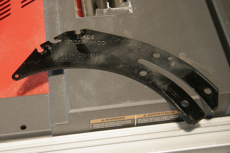

                      As to the riving knife, I've had a heck of a time trying to keep it parallel to the blade, which in essence makes it a tad wider (or shall I say thicker) than what it actually is. I think this was one of the hardest things to get in alignment. I ended up just snugging one of the bolts, as I would throw the knife out of alignment otherwise. At any rate, it may cause some issues with thin kerf blades.

                        If I may ask, what web site do you see it on. I'm curious because I am the author/keeper of the BT3 FAQs.
                        As for keeping the riving knife aligned behind/with the blade, the BT3 series has typically had a series of shims about .010" each on the mounting bracket for the riving knife, by placing the shims to the right or left of the RK when bolting it to the mount, it could be shifted reliably to align it. People have used soda cans sections to make additional shims, maybe this is what yours needs although I find it difficult to believe they don't already have some for you to use.

                          As to the riving knife, I guess the best way to describe it is that slightly askew. That is to say it's pivoting ever so slightly from the front to the back as I tighten the bolts, which in essence makes it wider than it really is. I like the soda can shim ideal and may give it a shot.

                              I have another knife here from a different model Sears saw. It is the 351.218330. It looks very similar to your knife, but I can tell subtle differences in the profiles. This one was once thought to be identical to the Ridgid R4512, but it is different from that one as well. Close on these is not good enough it seems.
                              Can you snap several more images of this mechanism on yours without the saw blade in place?
                              Thanks for posting this and maybe we can help get things sorted out.
