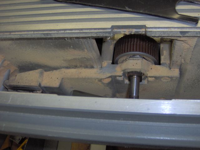

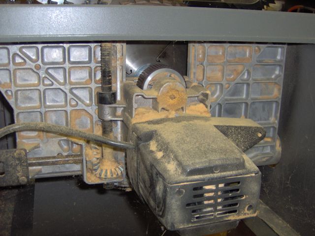

    He told me that the saw was in his storage for couple of years and after seeing cob webs inside the saw I think it was there for a lot more!!! The first thing that I noticed when putting the saw in my car was that the saw had a 15A motor and was made in USA in 1995 (XXX 9538)! So, I decided to take a look inside and see if I can fix the blade raising problem. Here are three pictures from the inside:

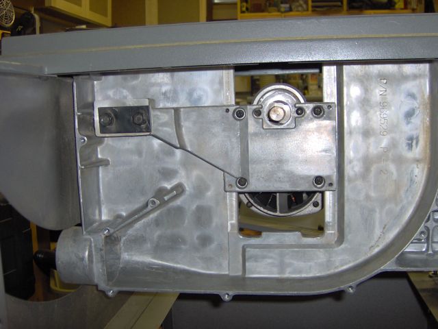

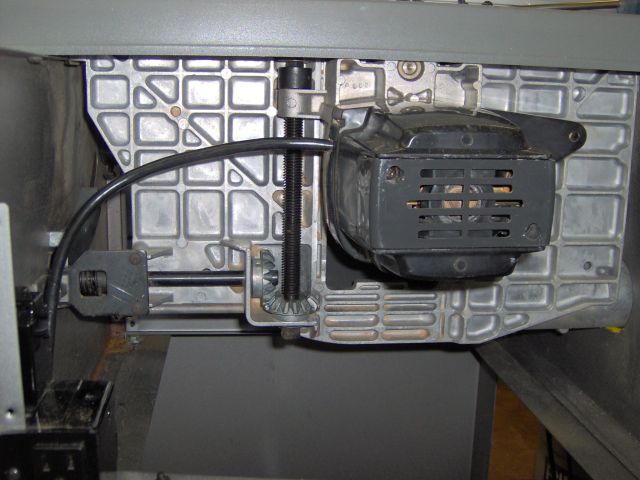

    Note that the picture for the Top and motor was taken after initial cleaning with the shop vac No wonder why I couldn't move the blade! The saw dust was compacted and hardened in most cavities and all the gears!! Used a utility knife and a long screwdriver to essentially pry the saw dust. Here are couple of pictures after cleaning:
Name:	Blade - after.jpg
ID:	797557Click image for larger version
Name:	Motor - after.jpg

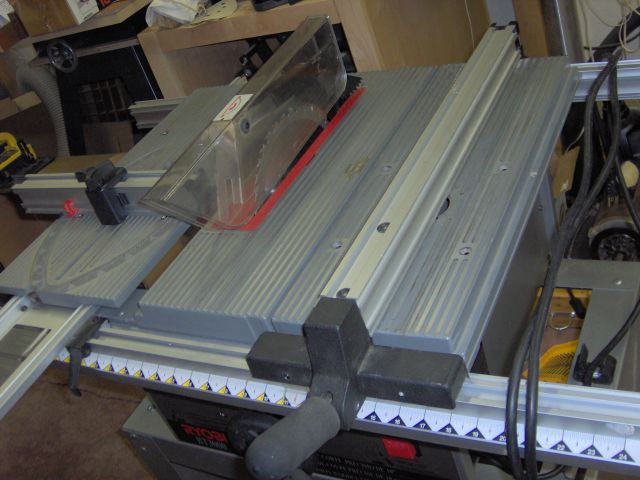

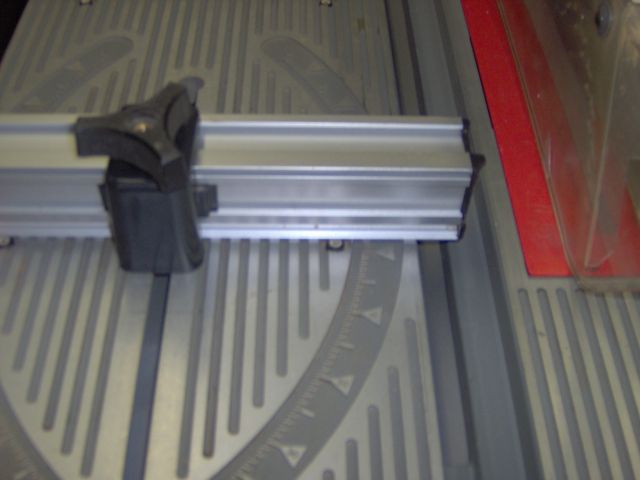

    Cleaned and lubed everything else (the blade looks almost brand new) and the bade moves up and down very easily . I then started adjusting the saw. The Rip fence was bang on but had a hard time with the SMT until I found out that it is missing part of the slides. Apparently, someone had taken one of the lower slides and use it with the other eccentric screw . I managed to get it working but the table does not slide smoothly! (I am missing a lower and an upper slide). The only other issues are cosmetics:

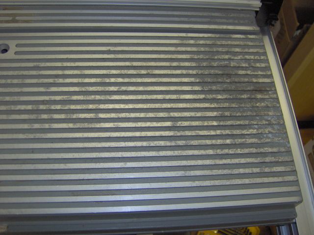

    As you can see the Miter Fence has lost it plastic end (I may or may not replace it). Also the Accessory table has some discolouration!! The switch is under recall and I have already talked to Ryobi and a new one is on its way.
    So here are couple of questions: 1) Any idea what has caused the discolouration and is there anything to do about it? 2) Anyone has made their own slides? M & D has them for 75 and 88 cents but there is $12 shipping and that only gets it to my friend in Wisconsin (I will try to see if Sears in Canada has them). 3) For those of you who use the Router Kit, how do you like it? Any issue with it?
    Turaj (in Toronto)
    • 22034
    discoloration is probably oxidation of the tops of the aluminum ribs. Are the discoloration mostly just on the tops of the ribs and not between them? Looks that way, maybe a bit of the gray in-between is flaking.
    They're normally machined flat on top leaving bare aluminum. you might take some fine (150-220 grit) sandpaper and sand the tops of the ribs using a sanding block, until the tops are shiny. Then use coast of paste wax to keep it that way.
      Am I seeing things. or is a piece of the aluminum housing between the blades teeth, in the second picture?

          ... you might take some fine (150-220 grit) sandpaper and sand the tops of the ribs using a sanding block, until the tops are shiny. Then use coast of paste wax to keep it that way.
          Thanks Loring. Will give it a try!
          I think it is just a shadow! There was a piece of wood stuck in there but no part of the housing.
              That little piece that "looks" like it is between the teeth is also visible in the 4th pict. It actually is behind the blade but the light makes it look like it is in the teeth. You can see that "tab" looking part in the 4th picture.
                  Saw the tab in the fourth picture, and to me it looked like the blade had been pushed back in the second and the arbor was further in front on the fourth, so I was all..
