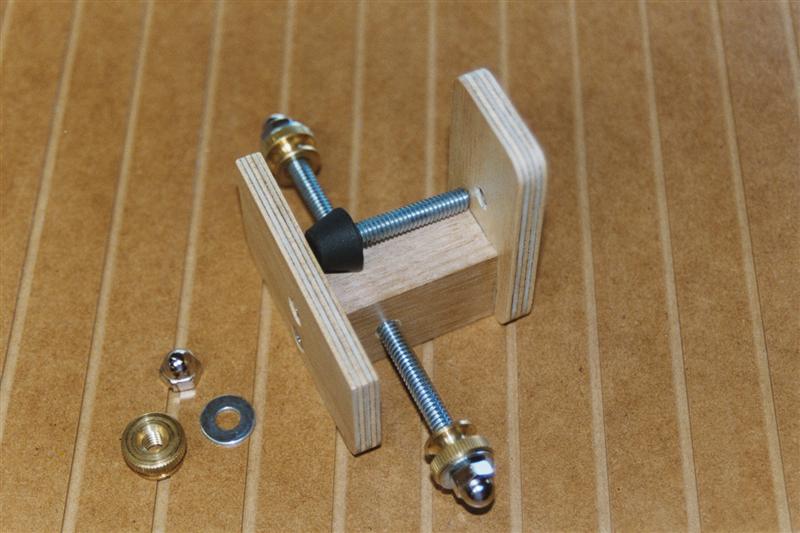

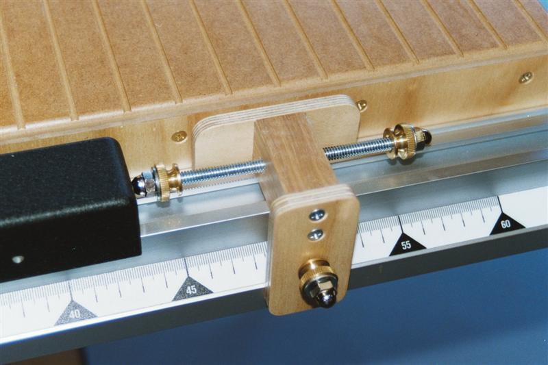

                  If you can't buy one at least one member has made his own. They all clamp/lock to the BT3 front rail and use a pusher rod and screw thread to move the T-block.

                  • RodKirby
                    • 3136
                    • Mao Shan TSC-10RAS
                    Ha - memories
ID:	785794Click image for larger version
ID:	785796Click image for larger version
                    Downunder ... 1" = 25.4mm
