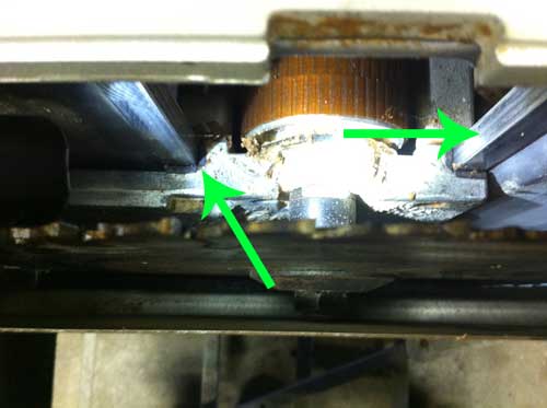

                Im going to try to post a few pictures, see how this works.
                I had some success last night, lubricating the saw as recommended. I had a bit of difficulty figuring out where to put the lubricant, but once I took off the throat plate, I could see the rails as in the picture with the two arrows. I used a silicone dry lube spray, and things worked better.

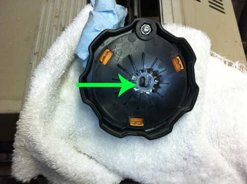

                Unfortunately it seems as though I have stripped the 'wheel' at the point marked by the photo.
                Guess I'll need a new one, I used a vice grip as a temporary solution after removing the wheel, and that worked ok, if in an ugly fashion.
                Also, while the lube definitely improved things, it still was fairly resistant to bringing the blade up or down, I'm wondering if there is a better lubricant I can use, I'd appreciate any suggestion on that.
                  I get the best results with just paste wax. I've tried several types of dry lubes, but never silicon. Silicon can be dangerous to use in a WW shop, as it can really interfere with finishing.
                  Before I lube I make sure everything is clean. It's easier on my 21829 since the saw is on it's side when folded up. I'll wipe down all 3 sides where the motor rides and then wax them. I also make sure the crown gears are really clean as well and the threaded rod. Then I'll wax those. I found that loading up a shop cloth with wax, holding it around the rod and then operating the crank works well.
                    clean and lube the crown gears and the vertical threaded shaft, too.
                    I also recommend paste wax rather than silicone spray.
                    Also, if the handle is broken, it may be hard to find a new one. my research summarized in the FAQ says that a 21829 handle will work.
