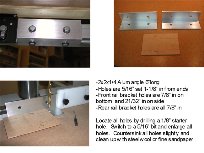

          These are aluminum connectors that Rod Kirby designed.
Name:	rail connectors.jpg
            • 22060
            there's several wasy to come up with your own.
            The cheapest is to get some strips of aluminum or steel the width of the T-slots and thread some holes in it for 1/4-20x1/2" bolts

                    You might take a look at doing an insert connector on your rails. They're very stable the connecting plates don't get in the way. Sometimes I had problems putting my accessory table where I wanted it as the plates were sticking out. You also don't have to take the connectors off to slide another t-nut to where you might need one later.
                      FWIW, I've tried this with both AL and steel. I was much happier with the steel, the 1/8" thick AL just didn't seem to be as strong as I wanted.
                      Another good, inexpensive and fast (no drilling) method that I've used is 14ga 1.5" slotted angle, about 8" long per joint. (HD and Lowe's carry this - about $6 for 2ft.) I like the 1/4" AL angle method from Rod best, but the 1/4" AL angle isn't typically carried by most home centers. (The 1/4" steel plates from KomaToast are probably even better, but I haven't seen the need to spend that kind of money.)
