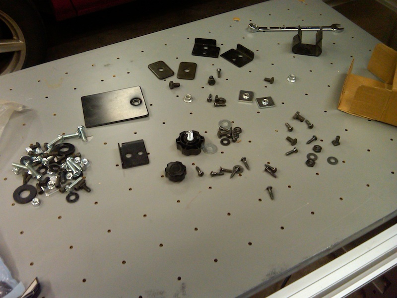

    I hope this isn't a dumb question, but I can't figure out how the quick fold table mounts to the rails. If anyone has a photo of how it attaches, I'd be most grateful.
    I've attached a couple of photos. Does anyone recognize what the parts on the table are for? I know the clip for the fence and such, but what are those black plates? I have the vacuum table attached, so I know they don't go there.

    The smaller threaded squareish t nuts slide into the underside of the rail and the table bolts on to those from underneath.
    The large black plate is part of the wide miter fence and bolts to the underside of the fence as a work support.
    The black pieces with the oval slot are stops that bolt to the front of the wide fence.

      The large plate is for the miter fence. It can be used to support long pieces. The L shaped brackets with a smaller angle at one end are stop blocks for the miter fence. I'll use them quite often when doing multiple cuts.
      Looks like you might be missing the connector plates with the chamfered corners that go to the long fence, as well as a few stamped T-Nuts.

        I couldn't find short enough bolts for using the silver T nuts, so I stacked a couple of washers and used the shortest bolts I had. I then attached the table, and as I was sliding it in, something stopped it. You guessed it...the correct bolts were already in the rail! It's now attached properly.
        The other plates I would have never figured out. Right now, it is set up as the long rip fence.
        Pelligrini, the connector plates are already on the long fence. Also, I looked everywhere online for a manual - great find!
